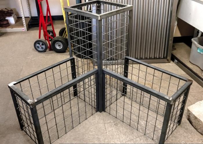

I'm a new welder but I have a project I'm working towards. I want to use angle iron and steel mesh to create some gabion structures. I plan to use 1.5 x 1.5 x 1/8th inch angle iron with 3" steel mesh.
When creating 90 degree corners I've seen the miter versus cope debate on this and other forums. With smaller angle iron the coping might be more work than is necessary. But... I'm not sure I can weld the outer 'knife edge' of the miter without either creating a ton of extra grinding work or burning through the edges and making it look like poo. Any suggestions on welding that miter (assuming that's the better joint option)? Oh, and I'll be making an x-y-z joint with a third piece that I plan to weld to the interior of the miter so I don't want a bead crowding my space on the inside of the miter.
Thanks in advance.
my planned project
my planned project

I have coped all of my recent projects. Coping is a LOT easier if you use a vertical bandsaw: either a portaband in a stand or something like a Harbor Freight 4x6 in the vertical position. Here's some pics of a cart I made for my welder and a small welding table I put together using coped joints. Coping worked out OK for me.

The only bandsaw I have is a table top woodworking version. I'm not sure if I can put in a metal blade and use it for this purpose. I'm cutting with either a grinder (7 or 4.5") or chop saw (not exactly an accuracy tool). I've seen someone cope with a hand held jig saw but I can see that costing a fortune in blades with as many cuts as I need to make.

Josh MacD wrote:The only bandsaw I have is a table top woodworking version. I'm not sure if I can put in a metal blade and use it for this purpose. I'm cutting with either a grinder (7 or 4.5") or chop saw (not exactly an accuracy tool). I've seen someone cope with a hand held jig saw but I can see that costing a fortune in blades with as many cuts as I need to make.
I cope every corner. The more weld you can get on something, the stronger it is. If you have a grinder, get a cut-off wheel for it to cope with or you can free hand cope with a chopsaw ...just wear safety glasses and stay off to the side of the wheel. Mitering looks amateurish.

I used to woodwork some myself (and carpenter work..hence my screen name) and mitering is customary in that profession but in metal, the idea is usually to make something as strong as possible. You can get much more weld bead on a coped angle or box tubing than you can mitering. Strength might not be a priority for your project but IMO every project should be as strong as it can be made. I also happen to think coped looks better.

Just hit the outside corner with a hot and quick down pass and weld the joint all around.
That'll give you some practice reaching in and around to get all of the nooks and crannies.

You should consider buying a portable band saw. They are really indispensable for cutting stock to be welded. You can easily build or buy a stand to use them in the vertical position. I even saw one guy who bought soft vise jaws and just chucked his portaband up in the vise. The best ones are Milwaukee, but I couldn't resist picking up the harbor freight portaband when it was on sale for $99. You can also find good used Milwaukee and Dewalt portabands on Craig's List for around $100 sometimes.

I've heard the harbor freight version is one of the few redeeming tools there and worth the $. But I've already sunk a bit more than expected into this process. The Long Haired General may balk at another $100.

Well you can cut copes with just about anything. I have done it with angle grinders and cutting disks, reciprocating saw (not easy to keep it straight), even a hack saw. The portaband will just save you a lot of time. It is one of those "how did I ever live without this" kind of tools.

I have built around 15 different stands out of 1" or 1.5" 11gauge angle and I have done both coped and mitered, and for the strength of the 11 gauge (1/8") material I don't find that the extra time to cope the material is worth it. I use a carbide chop saw to miter the corners. On the horizontal side of the angle I normally weld on the outside, just add a bevel about 80% the thickness of the material and fill with the weld bead. This makes a clean full penetration weld that you can quickly and easily grind flat. For the vertical portion, if there isn't anything that needs to fit right into the corner (not the case for you) I just run a bead up the inside corner. If I have something tight fitting to the inside, I will either leave a 1/16" gap or put a small chamfer on those edges as well and run the bead up the outside, which will again be easy to clean up.
As is mentioned before, I believe that the cope typically is a stronger joint, but in you configuration with the size material that you have I don't see a real advantage to the extra time and effort.

That's what I was thinking. I'm all for "over engineering" but an extra 5 min per cut on a non structural piece seemed like overkill. I'll definitely practice some cuts and welds on scrap first but thank you to everyone for the great input.
