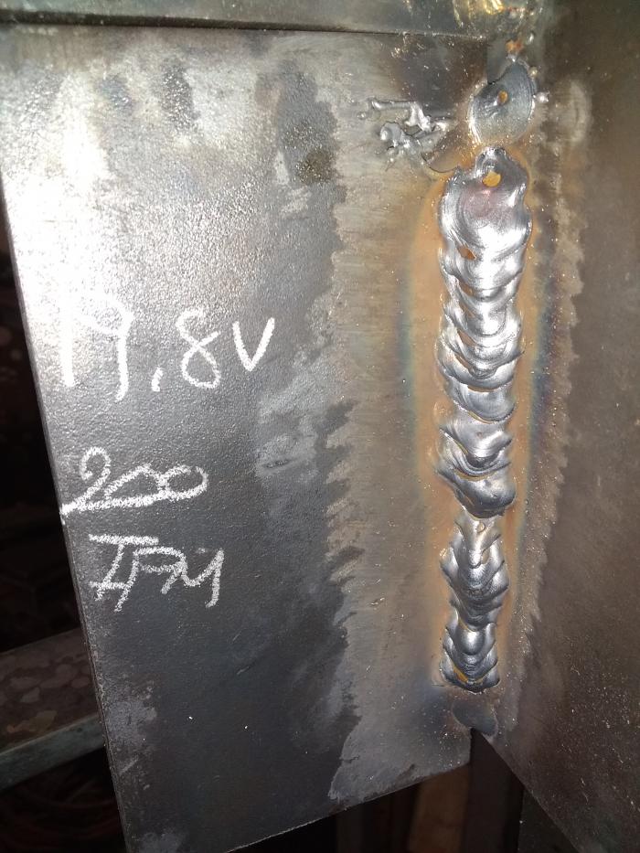

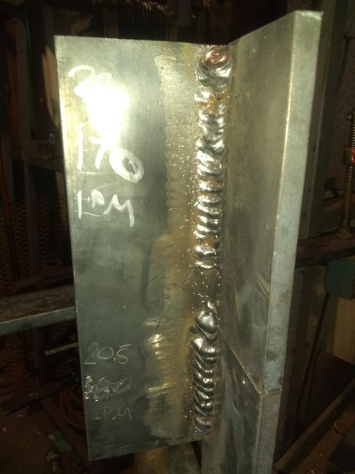

190/200 IPM still looks too hot based on the drooping But the 180 IPM looks very much better. I'm curious as to what the actual WFS is on your machine? Have you tested it (the WFS) based on the "6 second" method?
Negative never tried it, but I can MondayOscar wrote:190/200 IPM still looks too hot based on the drooping But the 180 IPM looks very much better. I'm curious as to what the actual WFS is on your machine? Have you tested it (the WFS) based on the "6 second" method?
Sounds good. My wire should be here tomorrow to give it another go and double-check settings.Havoc0122 wrote:Negative never tried it, but I can MondayOscar wrote:190/200 IPM still looks too hot based on the drooping But the 180 IPM looks very much better. I'm curious as to what the actual WFS is on your machine? Have you tested it (the WFS) based on the "6 second" method?
You should create an entire "map" so you can have a chart to refer to. Just my opinion of course.Havoc0122 wrote:6 seconds measured 38 inches. That's at 400 settings. So it's off by 20. 2 attempts today. 170ipm worked better than 180. -20
Another attempt soon
Is there a reference I can use?Oscar wrote:You should create an entire "map" so you can have a chart to refer to. Just my opinion of course.Havoc0122 wrote:6 seconds measured 38 inches. That's at 400 settings. So it's off by 20. 2 attempts today. 170ipm worked better than 180. -20
It seems like that top weld Saturday was the closest I've gotten so far. I just can't stop the sag. Slight slight bite on the sides... I'm looking forward to you giving it a go. I feel like I'm right there. The weld Saturday was 20.5v 180 IPM. Like I'm going one step forward then right back where I was.
- IMG_20200706_140946452.jpg (97.56 KiB) Viewed 3166 times
That's what I mean. You should create your own reference chart. IOW, do the 6-second method at many spaced intervals on your WFS dial, at least 10. That way you can have accurate WFS numbers for your machine. Just a suggestion of course, but that way when some one says "use 275 IPM", you can dial it in more accurately than if you were 260 IPM or 295 IPM and not even know it. The more points you do this for, the better dial'ing in you can do. Again, just a suggestion.Havoc0122 wrote:Is there a reference I can use?Oscar wrote:You should create an entire "map" so you can have a chart to refer to. Just my opinion of course.Havoc0122 wrote:6 seconds measured 38 inches. That's at 400 settings. So it's off by 20. 2 attempts today. 170ipm worked better than 180. -20

First try. Looks rough. I'll lower the voltage a little next time and play with the IPM keeping within the 150 to 160 range. That one was around 145 IPM (says 160).
- IMG_20200707_090331634.jpg (49.87 KiB) Viewed 3146 times
Keep in mind your machine will likely weld a little different, as mine is a completely different unit. All mine were done in shortt circuit. No pulse/spray here as those results would have been completely different. I was simply commenting about it in general with regards to wire type. S-6 is pretty much the most common, although sometimes S-3 can be had cheaper, but it doesn't respond well to millscale/rust/other impurities as well as S-6. Either wire can be used for spray or pulsed-spray, but we'll cross that bridge when we get to it.Havoc0122 wrote:Thanks obviously I'll do it you know your stuff that's no doubt. Thanks for the tip.
That looks like a nice V up bead. Im not sure if we're pulse or spray transfer. I've been trying to find out. So the wire is the main factor in that. Ah hah! The other welders don't prep their steel like I do (good habits) and they make beautiful welds still. I'll double check the wire today. I'll also drop to the 150-160 ipm. Will also adjust voltage according so transfer type. So less voltage for spray and a little more for pulse? Or do I have it backwards? I'm learning a ton it's great thanks.
Hopefully you have a ballpark idea of where your settings should be. You can always try different combinations of course, you just have to play with the voltage to make sure you are not too low or too high. I think your settings are pretty much spot on since the bead has a good profile. I think at this point its mostly just technique. This is actually the first time I welded 3/8" going uphill, so if I as a hobbyist can do it, anyone can.
