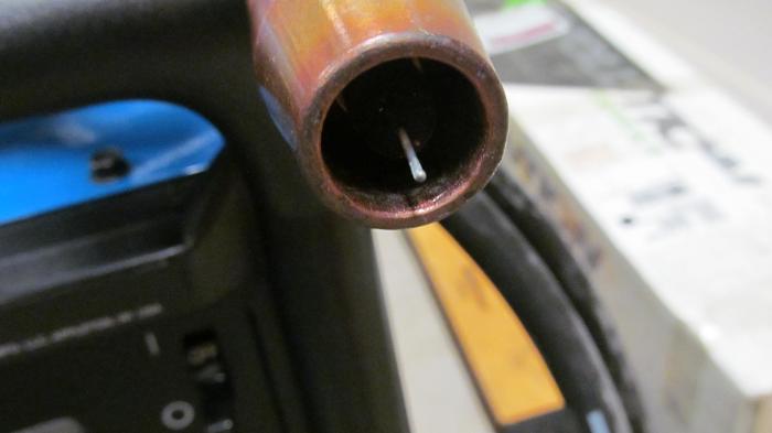

Welds looking good. The soot is because you likely have a very small diameter nozzle and couple with the fact that pulse MIG needs about 3/4" stickout and the arc cone is much wider than short-circuit transfer, you likely don't have enough shielding gas coverage. Post up a pic of the nozzle you are using, and how much CFH were you using on those beads?

That's what I don't understand, the machine was not set to run pulse spray when I ran those smooth looking welds, but they sure sounded and looked like spray.Oscar wrote:The machine IS capable of spray transfer. "Pulse MIG" is really short-hand for "pulsed spray arc MIG". If it couldn't do spray-arc, it would not be able to do "pulse", if that makes sense.FootSoldier wrote:https://www.google.com/search?q=spray+a ... TO6afgBw25
This is very close to what I was seeing and hearing on the two beads above. I know the machine is not capable of spray arc transfer, but that's sure close to what I was seeing.
I am running the Miller 250MDX gun, 5/8" bore on the nozzle, with the contact tip recessed 1/8", and 25CFH 90-10.
- IMG_1875.JPG (23.04 KiB) Viewed 2021 times
Oh ok, my bad, I had thought that was also in the pulse program. Yea the voltage is high enough that the transfer method crosses the globular threshold, together with the amperage. It's not quite true axial spray transfer because the droplet size isn't small enough, but none the less it does happen to me as well where it "seems" to go into spray because it turns rather silent and you don't have the typical short-circuit buzzing. Try a 3/4" nozzle with 40-45 CFH and you might see the soot start to decrease a bit. I've gotten that as well.
You don't need to be in a pulse program to go into spray arc transfer. You only need a suitable gas mix (which you have) and enough voltage (26.6 should be more than enough for 0.035 wire). So I believe you were just in spray mode (not pulsed spray arc)
