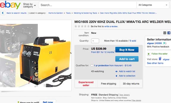

Well,
If you'd consider stepping down a bit in percieved quality, price, and output, this eBay-offered 160 amp, 220v unit might do the trick adequately enough, at $339, with free shipping and no State extortion paid in most cases. Surprisingly, it has a cast aluminum wire feed/drive.
160 amps.jpg (52.18 KiB) Viewed 2564 times

Mastiffman
    Sun Jan 15, 2017 2:33 pm
Thanks!
But the rest of it is fair good quality... Is this one that you've used or known someone to have used?
