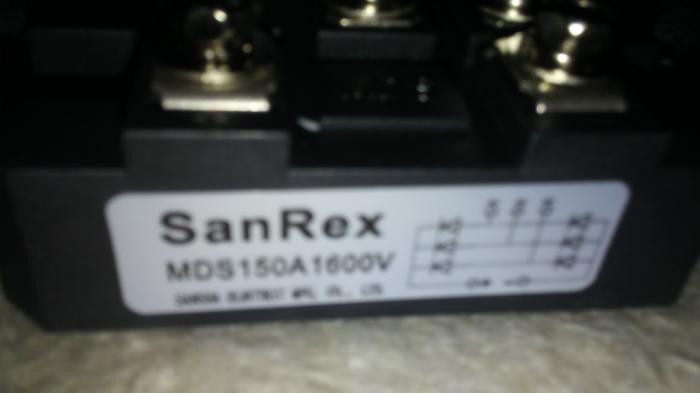

Hello gang, today I received in the mail the first part to start the conversion on my Chicago Electric 90A Flux welder......

Might I ask, WHY a 3Ø diode package?

Franz© wrote:Might I ask, WHY a 3Ø diode package?
One of the videos I found had the parts list to do the conversion, I used that list to find the parts on the web...........AZ

I'm thinking you have a totally wrong rectifier for your project. What you want is a single phase bridge. You also want some serious capacitors.

You are right, the information is not accurate, home internet is 89% down, electricity is 62% UP so is water, ..........one of the videos on this conversion says "learn from my mistakes" do not use the 100Amp single phase rectifier, it will die in less than a week, use 150Amp 3 Phase rectifier, I used the eb@y link provided by the video Author of the rectifier he bought after the 100Amp rectifier died............

AZlink wrote:..........one of the videos on this conversion says "learn from my mistakes" do not use the 100Amp single phase rectifier, it will die in less than a week, use 150Amp 3 Phase rectifier, I used the eb@y link provided by the video Author of the rectifier he bought after the 100Amp rectifier died............
3 phase rectifier may have been easier to get than a single phase.
it won't make any difference.
100A would have been to small which is why it didn't last long.
also pay attention to cooling of the module. heat is going to be a big limiting factor.
I was thinking an aluminium heat disipator from a desktop CPU with Fan just for the rectifier, the capacitor found one with 50V 50,000 uf, it hasn't arrived yet.
You picked the wrong part. that one is for 3 phase power, which the Harbor Freight welder doesn't use.

Now, to make sure I have to order a new single phase bridge rectifier because I got the wrong part..(it will not surprise me if you are right and I ordered the wrong one, it will not be a first time nor the last lol) I will check again with the videos watched........Thanks for pointing out where I made the mistake, this is why I like to post things, corrections only lead to perfection.

Hello again, check the snapshot in case I missed the name, I checked the site's url is not visible but if I missed it please tell a MOD to delete the photo............AZ
the 3 phase rectifier will work just fine. you simply don't use a couple of terminals. thats all, its still going to do the job.
a single phase rectifier will have been a bit cheaper thats all. no biggy don't sweat it.

AZlink wrote: I was thinking an aluminium heat disipator from a desktop CPU with Fan just for the rectifier, the capacitor found one with 50V 50,000 uf, it hasn't arrived yet.
i would check the open voltage of the welder, make sure its under 50v in each setting.
Thanks for the Tip, will report back the results..........AZ

Depending on how he configures the diode pack the OCVoltage could go above 50 leaving the rectifier.
