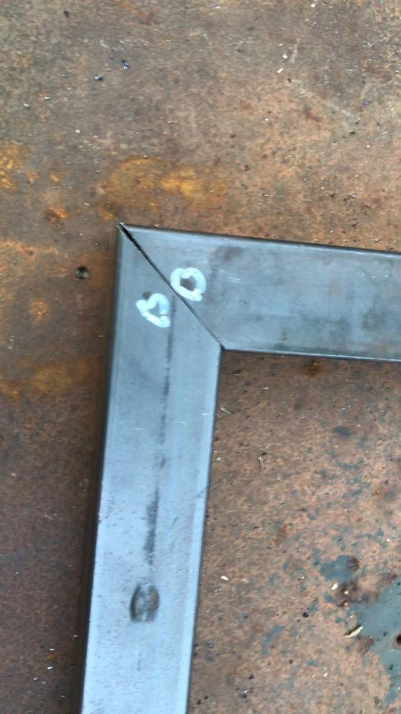

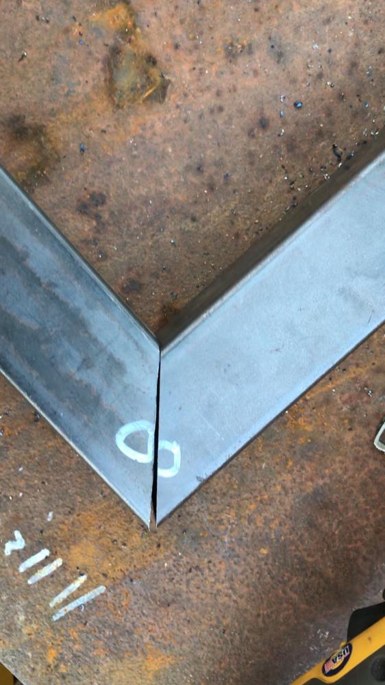

Yes, the clamp on my Dewalt sucks. I ALWAYS, have to go back and reset my metal.
I am putting a review on Amazon. I may have one. But, I will put the thing down to 2 our of 5 stars. I mean, I wasted so much time and money on the metal.
I am not one to give up. So, I will get more and just use what I have to make a smaller bench.
Someone online said the Evolution saws are the same quality as Harbor Freight stuff. But, you know what? My portable bandsaw I got from Freight works perfectly, for years. Actually, I drew an idea to make a stand using that band saw. If I were to get some ball bearings, and say, a pole, then a sheet of steel, I could have the thing set up so that it would rotate to a desired degree. I would just have to make something that would allow me to rotate the saw in a circular motion. You know what I mean? Not just turn, but move the entire thing to an angle. I am not sure that saw can cut angles.
I like making my own stuff. But the Evolution saw looks good to me.
The pictures show how great the Dewalt cuts. Now, as I said, the inside was good. But, the outside was way off. Actually, it was at least 1/4 of an inch off on the outside right after I made the cuts. I had to take my grinder and grind it down. Still, it is off. When I flip the metal over and look, it is even worse.
I am one who likes things perfect. I mean, someone told me I could weld a metal plate under the four sides. Why would I do that? If the thing was made correctly, I would not have to make something extra to add. So, it's start all over for me.
haha My step father, who is not a tool guy, though he was a captain at the Fire Dept. for like, 20 years, told me that I picked an expensive hobby and I should choose another instead. LOLOL Motivation it not his thing. hahahaha
Looking at the saw the person recommended, that a good working saw? I was going to get the Evolution Power Tools RAGE 3-DB 10-Inch TCT Multipurpose Cutting Double Bevel Compound Sliding Miter Saw. I like the way the bottom part can move and how i can put in either direction. But, if you think the other would work better, then I suppose I should go by the advise of someone who has used on. haha

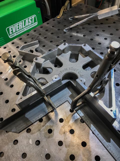

Cut on my Evolution saw..

Woodworkers curf in miters. A miter that doesn't fit well can be fastened in place, then a very fine handsaw with little tooth set is used to cut a curf , fine tuning the joint.
I suggest a sawzall, thin cut blade on a grinder, or a hacksaw.

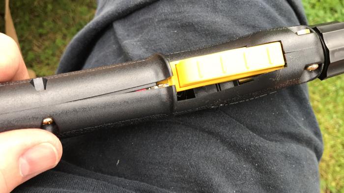

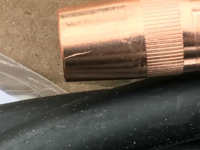

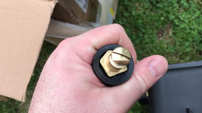

Well, my welder arrived today and I am pisses off.
So, it has been odd. FedEx delivered it four days late.
I open the gun first. I’ve never had one. I think it’s broken. There is a gap open on the bottom. I tell myself it is supposed to be that way.
I open the welder. I know I’m screwed. The cable that comes from the welder and goes into another, has a big part broken off. I mean, unless someone owned thebthing and hit it on metal, I don’t see how it could have happened.
There is one pack of drive rolls. I thought there were supposed to be three packs. Then, everything looks used.
I don’t know if it was sent this way or if Fedex had something happen and that is what made it arrive four days late. Now, I have to send everything back and wait for them to send me another.
I am going to tell them not to send through Fedex.

Someone opened that gun and didn't reassemble the innards correctly. That dense connector is bizarre! Someone hated that thing to shear it.
I'd be pretty disappointed too, but I'd make darn certain the Merchant Overnighted me a new unit. And sent a Prepaid Return label.

I don't NEED one. haha I was just excited to try mig welding. Plus, as I said, it was four days late.
I can figure out what happened to either thing. The gun, it's like someone opened it, broke the thing and just sent it back to Cyberweld. As for the welder itself, I mean, what would it take, to break the metal male end like that? It's odd. The way it is broken. Plus, there is no metal in the box. It's as if it was all owned before, broken, sent back and then sent to me.
