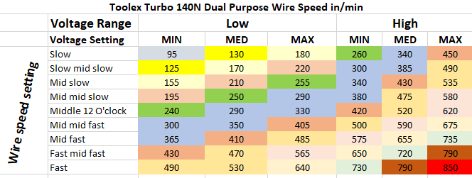

My question is simple. My old welder (now dead) and at least one other I have in the shed now, do not have independent wire feed and voltage controls. In other words the minimum and maximum wire feed rates, and all in between, are not the same when different voltage selections are made.
This means that if I were to set the feed rate to 250"/min in one voltage setting, when I change to a different voltage the feed rate would also change. Am I missing something?
I'm going to have to go and play with my welders and measure now.

I don't have a photo of the old one but it was a Cigweld Transmig 130 Twin. The one I have now that I believe operates the same way is a Toolex 140N Dual Purpose.
They both have voltage controls and wire speed control.
The 130 Twin had 4 voltage settings controlled by 2 switches, MAX / MIN and 1 / 2.
The Toolex has 6 voltage settings controlled by 3 switches, High / Low, MAX / | and MED / MIN .
They both have a wire speed adjustment dial from 0 - 10.
What I'm saying is that if I set the wire speed to say Mk 3/10 and just leave it alone (as per the video), I will get different rates of wire speed by changing just the voltage settings. So leaving the wire feed on 3, as suggested in the video, the wire will feed through at different rates dependent upon the voltage switch positions. Lower voltage means slower feed, higher voltage means faster speed. Without touching the wire speed dial the feed rate changes when you change the voltage.
The wire feed rate and voltage are not independent controls. They are in fact interdependent. The output from the voltage selection switches and the wire feed dial are both fed into the PCB which controls the pulse modulated DC current that drives the wire feed motor. Both of these settings determine the rate of feed.
This makes the video method not possible. Well it is possible but not as easy as it is made out to be.

Test results.
For each test the wire speed is set and not touched. Only voltage settings changed. As per the video and instructions.
1) Wire speed on SLOW (minimum)
Voltage Range set to LOW
Voltage adjustment MIN 95"/min
MED 130"/min
MAX 180"/min
Voltage Range set to HIGH
Voltage adjustment MIN 260"/min
MED 340"/min
MAX 450"/min
2) Wire speed set to 12 o'clock (middle)
Voltage adjustment MIN 240"/min
MED 290"/min
MAX 330"/min
Voltage adjustment MIN 420"/min
MED 460"/min
MAX 620"/min
3) Wire speed set to FAST (maximum)
Voltage adjustment MIN 490"/min
MED 530"/min
MAX 640"/min
Voltage adjustment MIN 730"/min
MED 790"/min
MAX 850"/min
Conclusion:
These results show that for this welder the suggested method, as demonstrated in the video will not work. I do now however have the required data to set the welder as per the suggested equations.
#1 These results can be read in reverse.
On the same voltage setting of Range LOW/MIN the wire feed adjustment will control from speeds of 95"/min up to 490"/min.
On voltage setting HIGH/MAX wire feed adjustment will vary from 450"/min up to 850"/min

Feed rate chart created from measurement testing wire feed rates.
From this it should be possible to use Jody's tables and multiplication factors to set this welder. From the video assuming we need a wire feed rate of approximately 250 in/minute you could select one of 4 settings (shown in green) to find which one gives the best result and then fine tune the wire feed from there.
I'll give it a go tomorrow.
- Extrapolated feed rates
- Toolex in per min.png (32.15 KiB) Viewed 2962 times

I did quickly try it out on the crappy Toolex welder yesterday and the result was that I had to use the highest voltage / lowest wire feed setting suggested by the table. Dropping the voltage back and upping the feed just didn't like it at all. I had some 2.75mm / 0.110" material and using 0.8 / 0.030 wire, so I was aiming at feeds around the 220 ipm mark from the calculation, which gave me the 195 / 210 / 220. Only the 220 at the higher voltage went near a weld. I think going up to the next voltage and winding the wire back to minimum (260) might have been better than going down and staying close to the calculated mark.

1) The welders I have here do not have independent wire speed adjustment. The Hobart welder shown in the video from the web pages does. On the welders I have here the output of the wire feed mechanism is affected by a change in the voltage settings. It is not consistent across the full range of voltages. This makes the process for my welders different. Slightly more involved but still achievable by the production of the little table above. So that was my first question and I answered it myself by measuring the wire feed output of all 3 welders across the full range of settings. The welders I have here operate differently to the Hobart machine Jody demonstrates with.
So now I went and tested out my calculated table of settings. This is where question 2 comes from.
2) I used 0.030" (0.8 mm) flux cored wire and when I put the welder on the calculated settings for 0.030" solid wire it didn't provide the desired result. It welded but I think there was something wrong and it is obviously the use of fluxed wire. The calculations don't transfer directly from solid to fluxed wire. My question is about the multiplication factor for flux cored wire. It will be something different to 1, 1.6, 2 and 3.5. I'll probably have to try to work it out for myself. I just though somebody might know.
The welding machine in question has no data, not tables and no real guidelines for settings in the user manual. This is why I looked at this method to determine settings for this particular machine. This scenario is exactly what it's for.
The Welding Tips and Tricks Website "Basic Mig Welding Part 3" page is all about setting a welder to run a good weld without any data. It is based upon the wire feed on a welder completely and solely and without any charts tables or numbers from a book. It is based solely on the thickness of the material to be welded and the diameter of the wire being used. From these 2 numbers a calculation is done to determine the necessary wire feed rate in inches per minute. The appropriate setting is found on the welder by simply measuring the output of wire from the welder and then setting the wire feed to the correct calculated point. Then you leave it alone.
After this is done the range of voltage settings is tested until the weld is running smoothly. The wire feed is not supposed to be moved any more up to this point. There is no mention of, nor need know, the weld current. It is all about finding the weld settings with nothing to go on but the thickness of the material and the wire diameter. Nothing from the wire manufacturer or welder. Just the thickness of the steel to be welded and the size of the wire.
To facilitate this, the calculation is done which involves multiplication factors of 1, 1.6, 2 and 3.5 for the different diameter wires.
Wire feed in inches/minute = Material thickness in thousands of an inch X the multiplication factor for the wire being used.
I had 2 questions.
In order to calculate the correct multiplier for your flux core wire you will need to know the cross sectional diameter of the wire. This should be available from the manufacturer, and will vary depending on the size of the hollow center of flux core wire. Then you can treat it like a ratio.
So you mean that I'd need to know the outer and inner diameter (sheath thickness) so that I can work out the cross-sectional area of the steel, sheath only? The other thing to do would be to accurately weigh a set lengths of wire for the different wires. If the length of wire were long enough or your scales accurate enough you could get a pretty close ratio.
I found length to weight ratios for a fluxcore and a solid wire but only in 0.045" and in different units.
To standardize I converted to inches per pound: Solid wire is 2260"/lb and Harris Dynashield E71T-1 is 2700"/lb. Approx 4:5.
Applying this ratio to the multiplication factors would give fluxcore factors of 1.25 for 0.045", 2.0 for 0.035" and 2.5 for 0.030". Probably not going to use 0.023" fluxcore but it would be a factor of 4.0. So basically I would just need to bump the calculated solid wire speeds up by 25% to get a rough starting point for fluxcore of the same diameter. Maybe even as much as 50% for smaller diameter / thinner sheath etc.
Either way it does explain why my first test run of this method wasn't what I expected.

I agree with you in principle, if this were an exacting procedure and method. However, the original premise is not a precision operation from the outset. Based on the idea of approximately 1amp per thou of material thickness and then a multiplier based on wire diameter gives only a calculated approximate feed rate. The welder feed rates obtained by measurement are subject to some error and slight variation as well. Once the rate is set close to the calculated mark, the range of voltages are trialled until the balanced arc is found. None of this is done to any significant degree of precision. This is, at best, a "ballpark" method of obtaining settings and I would think that at the end of the process, and after doing test welds, the wire feed may then require fine tuning adjustment anyway.
There would probably, or at least possibly, be variation in burnoff rates from one wire manufacturer to the next or even across batches. I think I now have an understanding of the problem I encountered and sufficient information to set this welder up to run based on metal thickness and wire diameter including FCAW. I've now added adjusted columns to my spreedsheat table so I'll put it to the test and see what happens.
EDIT: Just to throw a spanner into the works, in the material thickness range I have been using here, the weld settings guide table inside the cover of the Cigwled 150 MIG shows that the wire feed setting for fluxcore should be slower than for solid wire of the same diameter with the same voltage setting. For very thin material they are suggesting the same settings but above 1.5mm they say that fluxcore should be slower. This is directly opposite to the theory so far.
I suppose the disclaimer is that these are "suggested" settings only and that personal experience and ability will affect the results.

Yes the variables are almost endless. Part of another difference is that the flux does affect the weld process. It essentially uses some of the heat of the arc to do its thing. And polarity is reversed during the process most times, but I think some flux core wires I think are designed to run with the same polarity as solid wire. Another question that’s usually easy to research from the manufacturer.
That is assuming you know the manufacturer. Two rolls of wire I have obtained with a welder appear to be "generically" labelled. I'll have to take a closer look. I can't say I've ever used, or even seen, standard polarity fluxcore wire, even though I've heard of its existence.
