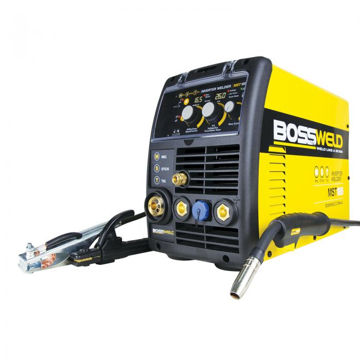

Bought this cheap $500 180 amp junior burger mig/tig/stick and a reel of 0.8 ( 0.30) flux core (cause gas is 300 bucks)
Anyhow I'm lucky I'm not Japanese or I'd commit hara kiri by now.
Ive watched over and over all of uncle Jody's mig videos but nothing helps.
all parameters i.ve tried result in microscopic beads and to attempt building a decent size bead man its like,....like,....waiting for xmas.
the op manual suggested parameters mean nothing and say 19 volts/ 250 ipm it spits n farts and leaves what looks like a bad solder job.
for it to SOUND right, like a constant buzz and not splat,splat,splat, the tip is buried in the puddle !!!
IS THIS TO BE EXPECTED ? Until I learn ?
it has taken about two feet of snot (and two tips, and 20 feet of lost wire) and still the bead looks like a paint run.
heres the welder advertised on Ebay tho' i didn't buy from this mob.
https://www.ebay.com.au/itm/Bossweld-18 ... 2272577149
Its a great sticky welder and I'm hoping the MIG problem is just me and not the machine.
Are MIGS always that loud ? AND SO BRIGHT I CAN'T SEE THE WIRE FOR THE LIGHT SHOW ?
