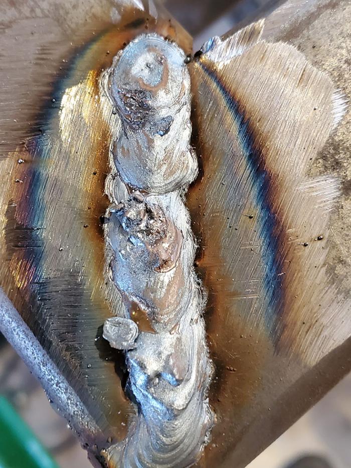

what should I do to make these better?
Millermatic 215, 030 wire set at 1/8, one vertical one horizontal.

You left out a lot of info
Top pic is horizontal and bottom pic is vertical? (both "look" vertical based on the picture orientation)
What thickness is the metal?
What stickout are you using? (no guess, actual number from contact tip to the work)
Picture of your nozzle and contact tip on the gun? (Wondering if it is recessed)

top pic, settings look ok but i think your manipulation is a bit off. what style do you do?
bottom pic, that has a lot gone wrong in it.
its better to run uphill rather than downhill. use uphill to your advantage.
for a downhill weld it looks way to cold and slow. manipulation looks way off.

I'll buy your $0.02 for a dollar ;) I agree with your assessment completely.
Personally, I think stickout distance gets a bit too much play. I think heat at the machine provides a great deal of results. Too low on Volts, cold welds. Too fast on Wire Feed, welds get bulged up. Manipulation of the gun, your physical movement along the weld can conquer these variables slightly. Get all 3 wrong and you get poor welds.
Your downhill welds appear as though you had a very acute "push" angle. Try maintaining a more "square" angle to the work whenever possible, in all positions. You will invariably add some push, or pull due to eyeline and movement. That's OK and perfectly acceptable.
I'd encourage you to practice flat, then horizontal. Get the puddle manipulation down and learn to see the correct puddle. This will help train your manipulation for other positions. You will be able to self-correct as you weld more easily.
In the end, they're not bad for early practice. A few "tweakes" and you'll be rosy :)

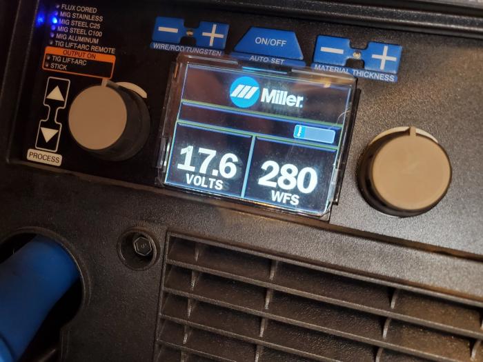

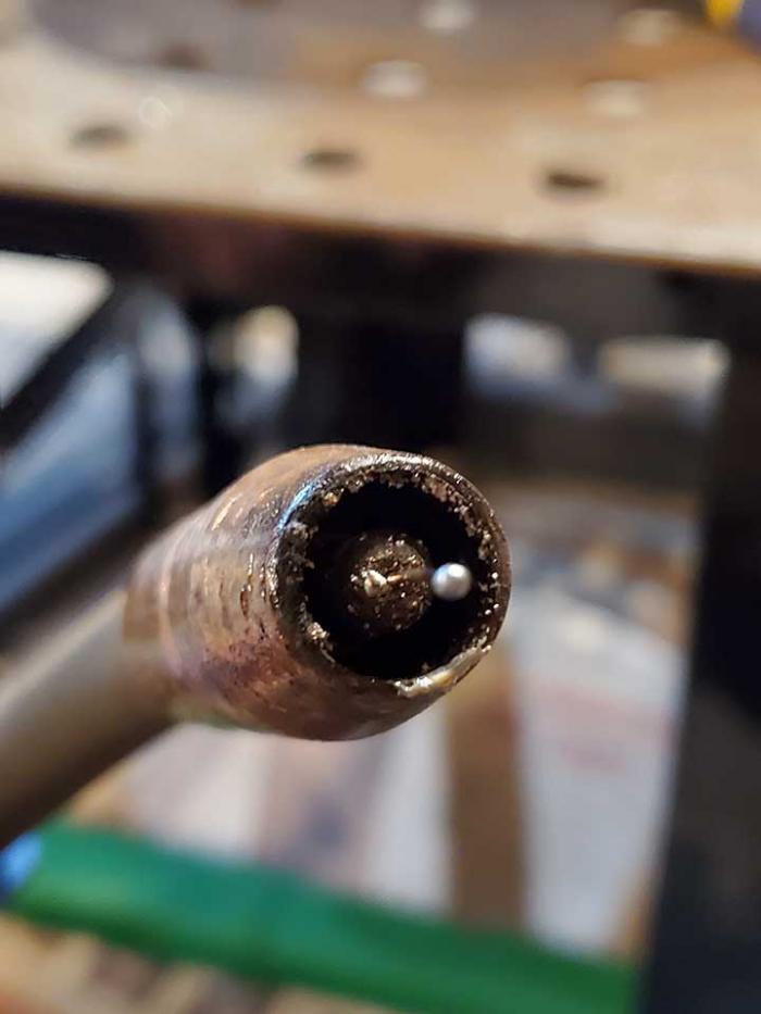

here is a short videos and some pics from this morning.
https://www.youtube.com/watch?v=Lz5HbKH3c6c
This is the tip after welding, gas is set at 25.  bottle is 75/25
the setting on the Welder

Yes they are very cold, and I'm willing to bet you are welding on either 3/16" or 1/4" steel, not 1/8" as you had stated, just going by my perception of the material thickness in your video relative to the other items I see there. Can you/have you actually measured it's thickness and provide confirmation? It's definitely thicker than your welding table-top which looks to be 1/8" to 5/32" in thickness.
On another note, replace your contact tip if a spatter BB has welded itself onto the bore since it might cause feeding issues. Your stickout looks good, maybe just a 16th too long but still somewhat acceptable, so I'm willing to bet the crowned-up beads are mostly related to my point in the previous paragraph. You also appear to be backing up into the weld bead with each forward progression, which would make the filler metal pile up higher even more.

It's interesting to see the difference in machine "suggestions" for 1/4" steel on 030 wire. Mine gives 629 IPM with about 27-28V for the same thickness, but I dial back the voltage to 25V! Where as Miller has much lower starting points. Your beads are starting to get "flatter" which is good, IMO. So it turns out that you actually had 1/4" steel after all?

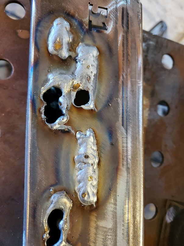

Thanks, working with 1/8th today and I'm blowing holes left and right. Set it down to 14 guage, same thing. Turned off autoset, set the heat at 16.5, wire speed at 224, welds start good, then it blows a hole.

First please make sure your polarity is correct since I know you were messing with TIG with it as well. Also make sure you are not having wire feeding issues. When the wire gets hung up for whatever reason, the arc can still emanate from the contact tip and that is almost like a TIG arc - heat is being produced but with no filler metal deposition, the heat can blow a hole. Assuming those two are correct and working properly, then it's just a matter of playing with the settings so it doesn't blow through. That is the main journey of welding once you have the basics down. Learning heat control along with metal deposition rates IS welding. So you're simply at a stage where you have to invest the time to learn your machine and build develop your technique so you can learn how to weld. Play with the voltage to learn to control bead profile. Play with the WFS to learn to control filler metal deposition and amperage.
