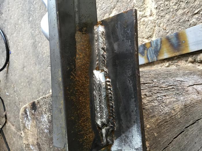

yes, I will post some pictures. I have been practicing on 10 gauge (.135") horizontally and vertically T-bar and flat, last night I practiced on some exhaust tubing and was getting it dialed in close until the supper bell rang. The wire I'm using is US Forge ER70S-6 which I read on another forum was a good wire but, it's China made also. Is Lincoln wire worth the extra 10 dollars per 10 lb roll? 40$ verses 30$. The welder is a Sungoldpower https://sungoldpower.com/collections/mi ... elder-200a, I don't see the voltage output in the specs but the adjustment dial goes past the 26 mark printed on the face. The wire speed says 16 meters max per minute which I thought was 629" per minute max, that I can verify in real life with a stop watch and a measuring tape, give my 10 year old grandson a math project. I ended up buying a full 125 cf bottle of argon/Co2 off of craigslist because of the price ($150) which the seller did put a gauge on it and showed 2000#, close enough. The bottle flowmeter is actually scfh not liters like I mentioned above so, I am flowing 20 scfh when I am welding. Who knows if it is really the correct mix in the bottle but for now it will do, there is no splatter. I think I will just have to learn where the settings need to be and write them down and make my own chart, there was no setting chart that came with this machine. I figure once I learn to weld a "decent" bead in all positions I can upgrade to something with more features. BTW the manual is terrible, not worth the paper it was printed on, which I have been conversing back and forth with the distributor about a parts list and customer service but, the companies in China don't care about the individual sale, for the most part.
Deano56
    Thu Dec 10, 2020 11:28 am
Here’s a picture, this was vertical

Welds are not horrible, you just need practice. Keep the stickout short, about 3/8" from the contact tip to the work. 1/4" if you can manage it. It really helps flatten out the bead without resorting to excessive voltage. But yea, you just need more practice, which will take time if you do not have anyone to teach you how to actually learn how to MIG weld. One trick I use at times, is holding the MIG gun as best as I can with one hand and adjusting the voltage with the other hand both up and down to find the sweet spot. For wire Feedrate, you need "enough" for the metal thickness you are trying to weld. That's the difficult part if you don't already know just how much feedrate you need in the first place. But it doesn't look like you are far off. Most wire is pretty decent. Heck I've hardly ever used anything but overseas produced wire, and I have no problem making a clean bead. Lincoln/hobart wire will run nice, and might produce less silicon deposits, but most wire is still pretty decent.
Both of these were made with china wire.

Deano56 wrote:That’s how the guys at work weld, nice. Is that going side to side with the torch while pushing or pulling? Dou you think I should be using .030” wire rather than the .035” with this size of a welding machine.
Using gun manipulation, no. Both of those are straight push, with no weaving, no gun manipulation. Just a crap load of WFS and voltage.
As for the voltage, too little and you will literally feel the wire push the gun back towards you as it starts to stub into the part without enough overall power (amps x volts). Too much and the arc will fan out too much and the wire starts to melt before hitting the part, producing lots of spatter as it starts to transition into globular transfer.
For a "regular" MIGs such as yours, I would keep 030 wire limited to about 160A. If you need to run more than 160A, then 035 is better suited, IMO. You can either put a clamp-on ammeter to actually measure it, or you can can find a crude approximation using the relationships:

You might want to clean some more of that Mill scale off your parts first. Welds do not like dirt.

Doesn’t look like it in the pics but, I did remove milscale at the weld areas

Yes, I do see some swirl marks very close to the weld beads where it was ground down. Sometimes it's just tough to tell with the inevitable smoke and spatter.
