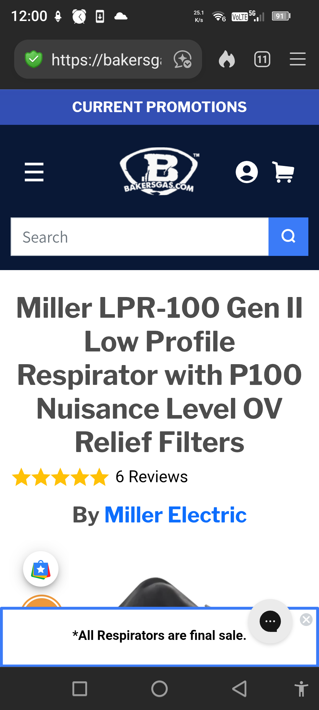

Ok hopefully not a dumb question. I started a mig skills class is only 5 weeks but first day today. Welding mild steel with C10 and the way I weld I am basically laying in the damn weld once I'm awhile I would feel a little wobbly probably from lack of oxygen, being so hot and being tired but are these gases actually really dangerous? Especially with me being like right over the darn weld, I'll try and practice to see if I can stand off more but even with magnifiers is hard to not get up and close, wouldn't be able to fit respirator under my helmet I don't think
Argon displaces oxygen. Saturate your breathing with argon for long enough and you’ll experience issues. After heavy TIG welding days, my throat is often very raspy.
They make helmets suited for respirators and fresh air systems. You might want to invest in one.

Might see if I can adjust the fan to blow across my face to blow fumes away without affecting shieldingI'm not investing in a fancy hood and clean air respirator for a 5 week class I don't even want to see what a setup costs lok. I am doing class for hobby I don't do this for s living. For s school they should have better ve tilation and hoods for each stall I would think
Well just found a really good deal on a very nice used lincold 3250D FGS with the papr ventilation system so yay me lol. Would have preferred the 3350 but at least the 3250 I can flip it up and just keep it on and cannot beat $1000 for it
