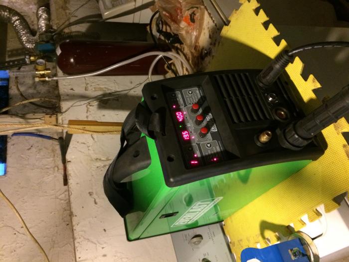

I'm running 75/25 ar/co2. Sorry I wasn't able to get any pictures posted yet. I went home tired and called it a night. I'll try to get some tonight. The picture I attached here is one I took a week ago. Not the best picture, but I'll take some more.soutthpaw wrote:What gas are you using?
- image.jpg (55.06 KiB) Viewed 2403 times
What size wire are you running? Assuming you are using .035 your wire speed of 400 is way to high for the voltage shown. Try the wire speed in the 220-250 range and adjust from there.

Yes, I am running .035 wire. That's not the settings I was using though. That's just a picture I took last week after turning on the welder. It was set like that.Superiorwelding wrote:What size wire are you running? Assuming you are using .035 your wire speed of 400 is way to high for the voltage shown. Try the wire speed in the 220-250 range and adjust from there.
Have you been able to play with your machine? Can you tell us the settings you were using and the settings you might be using now?

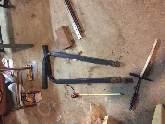

- Some scrap steel from old rusty BBQ
- image.jpg (56.96 KiB) Viewed 2363 times

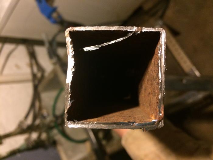

- 2/32" thickness
- image.jpg (33.29 KiB) Viewed 2363 times
- One of the settings I used
- image.jpg (53.56 KiB) Viewed 2363 times
If your welding steel from 16ga to 3/16", try 19.5v 225ipm

There isn't any weld, because it just burns right through. So what I ended up doing was spot welding in all the burn through. Then I took a grinder to it and smooth it all out. It's ready to weld, just haven't gotten to it yet since I been busy.soutthpaw wrote:Pictures off your actual welds would help
AKWeldshop, thanks for the suggesting. I'll try it out. Probably during the weekend.
If you are welding at your job too why dont take some thicker scarp plate and start adjusting there. then you can keep you arc on and tweek it there and not worry burn trought. So get better practise material and not that rusty tube. Every that size machine will short sircuit for sure
