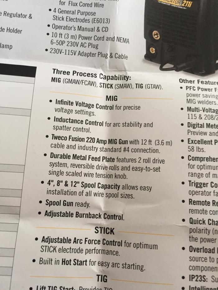

that tweco won't take a twelve inch roll.

Care to show me some proof?
You are mistaken. It will take a 12" roll.

well, I would have to defer to the hard copy. there are several out there like this. in fact I buy a lot from IOC and had looked at this unit just recently.
http://www.weldingsuppliesfromioc.com/t ... HwodPkcA_g
http://www.weldersupply.com/P/605/Fabri ... tWFREESHIP

All I care about is facts.
The fact is that a 12" 33 or 44lb spool will fit in the Tweco fabricator 211i.
I don't see how you can deny this.

Fight night.... I'd say forget the literature, the picture settles it. Unless there is a different model for the same machine.

Perhaps the larger spool will fit, but TWECO does not recommend using it? I'm thinking the drive motor may not like the heavier weight. Maybe both are correct?
If you take a close look at the 252i, it looks about the same size (I don't have the manuals in front of me). Could they have used the same chassis but used a smaller drive system for the 211i? If that's the case, a 33 or 44 would fit but may not be best to use.

OR one production run of the machine and literature recommended spool sizes but needed to be changed after some customer feedback (my drive motor burned up)?

Well,
First off, if Tweco has determined that 12" spools put too much load on the drive system, or are otherwise harmful to the machine, I did not know about it.
I just have seen plenty of literature supporting a 12" spool, and put my hands on several and seen first hand that they would fit.
I also see plenty of websites are still saying 12".....
Including Tweco's website.
