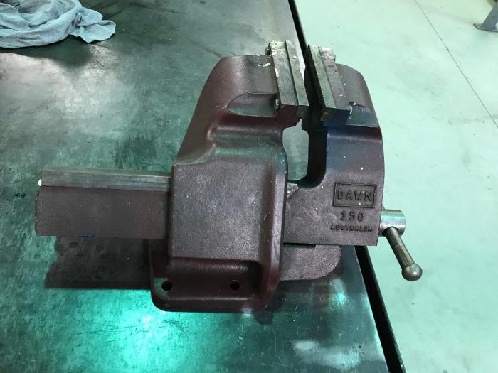

A shop I am working out of recently has a 150mm (6") Dawn offset cast engineers vice weighting 55kg (122 lbs), not mounted.
I offered to fab up a movable vice stand, maybe with a truck wheel for a base. They told me to go ahead.
So not having done one or used truck rims before, I thought I would seek the advice of my forum cobbers (mates).
Materials?
Rim size?
Suggestions?
Thanks guys.

All that said, don't disregard a good tripod. We've got one at work that's old as the hills and is made from 30mm or slightly bigger (but not huge) thick wall rhs. Simple 3 legs steel plate and bracing put around the bottom about 5" up. It's great for general heavy use
Thanks for your advice Franz, got me really thinking about it. I presented the options to my customer who said that the vice will mostly be used for holding copper tubing while silver soldering, they wanted it as cheap and quick as possible and to use drops and cut lengths off the rack.
So the brake drum it is, unadjustable, 1/2" plate top and bottom and 100x6mm square tube (4"x1/4") is what I got and 12mm (1/2") bolts.
Bottom weld is beveled and gapped full penetration weld. Top weld is fillet. All mig 0.9mm (0.035) wire.
Leg is offset to get close to the mass centre of the vice.
Drum was $20 from the local truck wrecker.
Not bad, if there was going to be heavy work, a better base option would be useful, but hey it's better than what they had.
