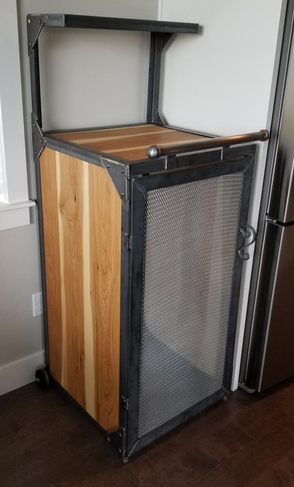

Here it is

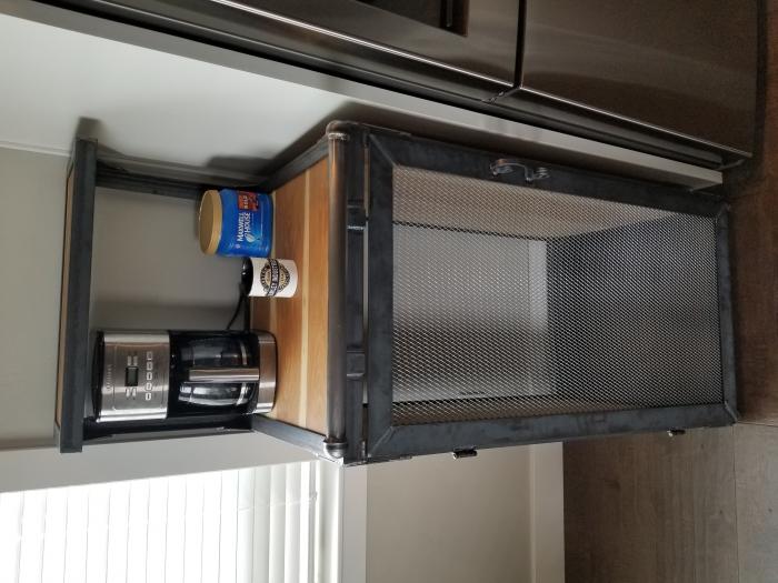

Coffee cart on top

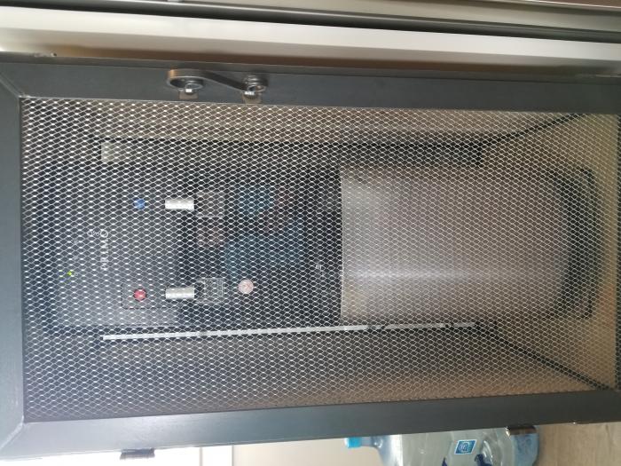

With the water cooler installed

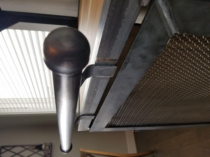

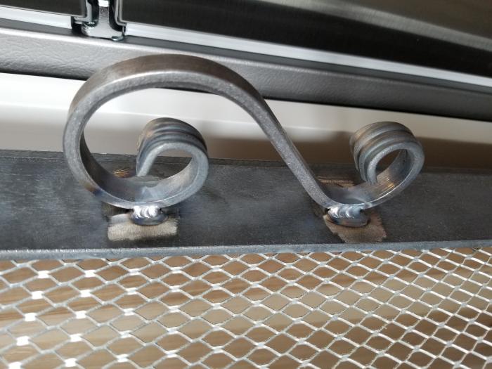

A few detailed shots

motox wrote:Burley
are you using gun and bucking bar on the rivets
or just tac welding the backs?
They start as carriage bolt. I chuck them up in the drill and smooth the head on the belt sander. I then cut the head off leaving the square shoulder. I drill a hole big enough for the shoulder to fit in and them tig weld the back side and grind smooth. It's a lot of work but it's the cheapest way and allows for all different sizes.
