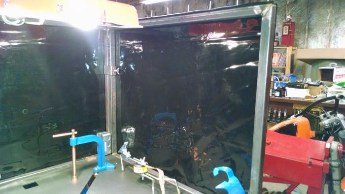

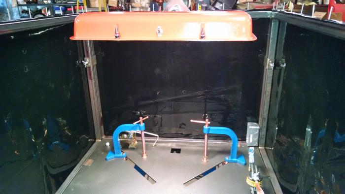

I made some curtains for my workstation, 1" square tube and it is made to disassemble to move or haul around. The frame is 3 pieces and just clamp to the table. The frame is made so the bottom tubes sit flush with the table and the curtains can roll up so if I need to put something long on it and they won't be in the way. I added a light I made from a Chevy small block valve cover. I still need to paint the frame and I am going to take a drop cord cut off the female end and wire it to a receptacle in a jiffy box and clamp it to the frame. The light is also removable.

Thank you Darrin, I made the frames from 1" square tube and bought a full size curtain and cut what I needed. To attach them to the frame I folded the edge over so it's two ply and used large head pop rivets. The curtains main purpose is to block the wind when I take it outside, arc flash is not much of a problem because I am usually the only guy in my shop.Darrin wrote:Fantastic job mate! Love it. Did i you cut down full screens to make these?
