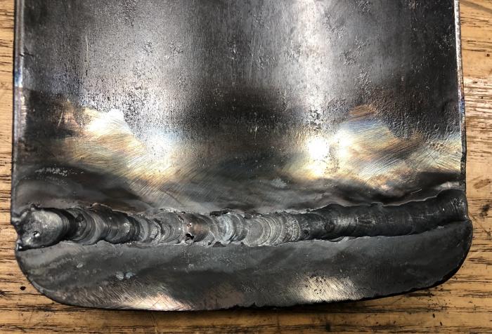

Here is after my weld pass, which I hoped would do the job. It did not succeed.
- IMG_4731.JPG (66.52 KiB) Viewed 2502 times

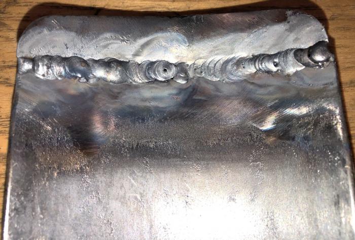

Here is the back side. I failed to go hot enough.
- IMG_4733.JPG (64.54 KiB) Viewed 2501 times

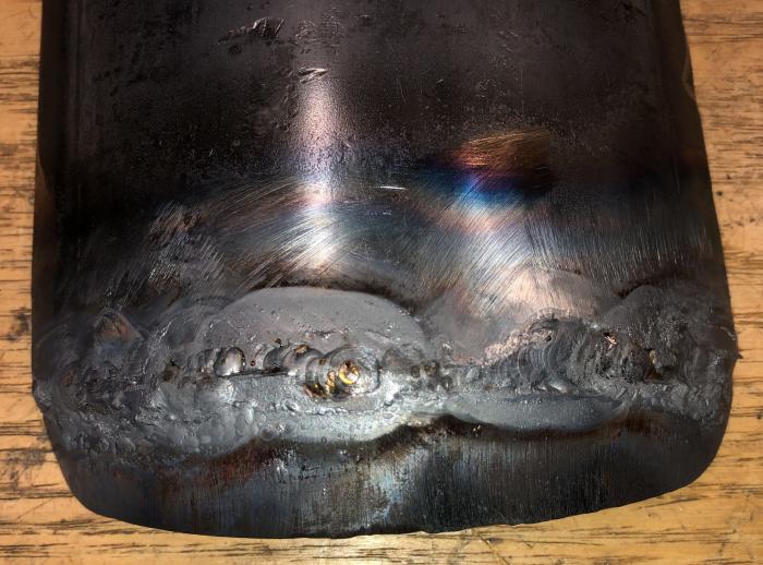

At this point, I was lost because I had both cold welds and undercut. I decided to just run another bead over the first bead, using plenty of heat. The welder was set at 65A max because the plate had thinned to .063" during the flap disk step.
This is what it looked like after that second pass.
- IMG_4742.JPG (73.38 KiB) Viewed 2500 times

I am a little frustrated, but I can see that the increase in cleanliness made for a noticeable improvement.
In my mind, I know a lot of what I need to do, but my lack of hood time is showing here. I just need to practice a bunch more.

Kudos to your efforts on welding practice, but I think you may be on over kill mode on this job. Could this part be formed in one piece? Either hot or cold? A small hydraulic press or even a screw press may have enough grunt for forming cold.

Fair enough. For this application, I would try simply fusion the steel with no filler. The parent metal should flow enough to join well. It won't be proud of the surface, but it'll do the job. Remember, nice sharp tungsten, short arc.

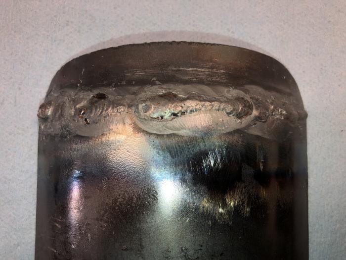

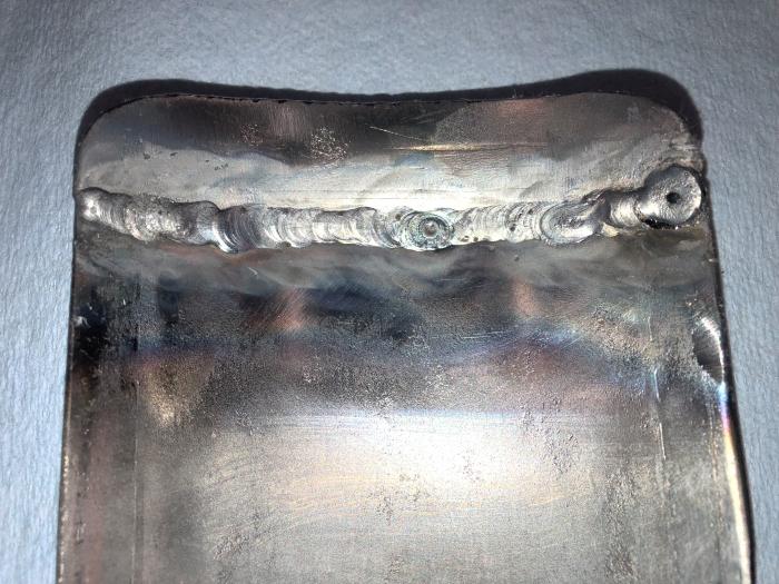

Here is the most recent bead that I made. I gave up on the wire wheel for removing the mill scale. I also tried 60 grit emery cloth pulled tightly on a large flat file, but for some reason the surface of the steel sheet was not flat after its trip to the hydraulic press. I now use the flap disk.
I am still wondering if brazing with silicon bronze can be made just as strong. I read this https://www.brazingbook.com/brazing-vs-welding/ and almost at the very bottom it says "Brazing advantages: joint strength,..". I didn't expect to read that; I think that many people would disagree!

If an internal rim had ribs running lengthwise, it would be VERY strong. The pressure from the inner tube against it will limit deformation. The weight bearing on it directly at any point is limited to the weight directly above it. The balance is then distributed. Just an FYI.
