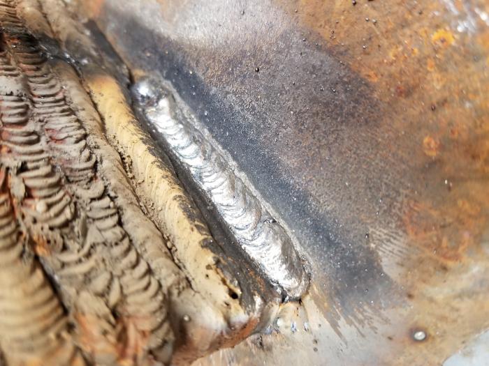

Honestly when I saw the 6010 bead picture I spent a good minute thinking "where's the 6010 weld?" too I can see 6010 characteristics in the stops and starts, but I don't think people are that skeptical of the machine running 6010, we just don't normally get that bead appearance. I haven't ran more than a few 6010 rods in months, so I am terribly out of practice, but this is more what I'm used to when I drag the rod.
Still though, it's my experience that 6010 tends to be a little smoother and cleaner than 6011 as you clearly experienced, which makes being able to run it a plus, although some 6010 optimized machines really seem to "dig" more with it, it can be as much of a hindrance as a help if you don't routinely use 6011/6010.
