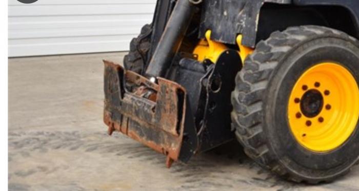

Had a guy call me ,told me he had a crack take an hour to weld . What do you think?

This is a similar machine ,notice the l shaped boom. The owner tried taking out a stump by slamming into it and bent the lower part of the boom,putting the mounting ears into a bind. Rolling the bucket back eventually cracked the bucket and ripped the ear out

The repair, prepped everything for welding .welded up cracks left ear lose . Mounted to machine to get pins to line up,rolled bucket to get ear to find happy spot then put baby tack on it to see if there was any bind. Rolled again tack didn’t break all,good.all welded up ,ear moved 1/4 ,3/8 of an inch from original position .
Sorry forgot to get finished photos
Time 5.5 hours prep. 2 hours welding
Bls repair wrote:The repair, prepped everything for welding .welded up cracks left ear lose . Mounted to machine to get pins to line up,rolled bucket to get ear to find happy spot then put baby tack on it to see if there was any bind. Rolled again tack didn’t break all,good.all welded up ,ear moved 1/4 ,3/8 of an inch from original position .
