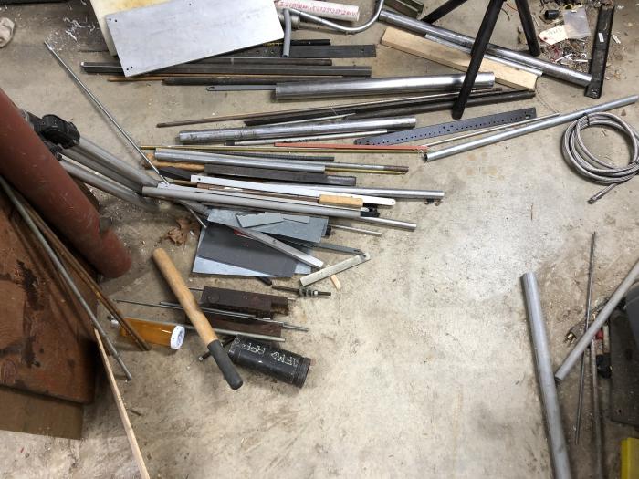

I keep a mixed pile of stuff to have a stock around my shop. Most of the smaller stuff is in some wooden boxes I have on a shelf under one of the benches but the longer material was sort of piled in a corner. It was always spilling out onto the floor and was just generally hard to pick through and in the way.

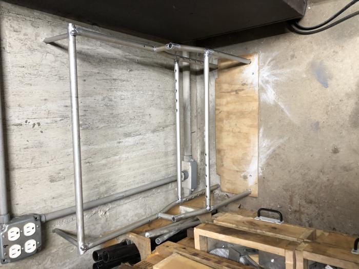

So using stuff I had in that pile, I made this goofy little stock rack. Most all of the material came from the remains of a set of aluminum crutches that I pulled from the trash someplace. No idea what the alloy is but I tried a few test welds on some scrap pieces and it seemed to weld OK. These aren't really mission critical welds (none of my welds are, thankfully...) so good enough for me.
I'll spare you closeups of my welds so as not to make any of you ill, but in any case the thing is stuck together. I used the aluminum tube just because I had it and it was not useful for much else. I gave me some practice on welding aluminum and on welding tube joints. I was reminded how critical it is to have the joints CLEAN before you try to weld them. I also learned that welding tube joints is some sort of magical thing that I have zero magic for. The only magic thing that I had going on was the magical attraction for my tungsten to find the puddle. Over and over. And over. So I got lots of electrode grinding practice in as well.
I considered just buying some square steel tube to make this but sometimes it's fun and a good exercise to try to make something just using what I have on hand. It makes you use your brain a bit and you never know exactly where you end up, which is part of the fun.
My stuff is now off the floor and roughly sorted by the type of material. It's a lot easier to pick through to find what I want.

The rack looks great to me. And ifyou're not happy with the look of the welds close up, aluminum is really easy to go back and fix up. If it was dirty, spray it with water from a squirt bottle and use a carbide burr to remove most of the weld metal along with ALL of the dirt that boiled out, then go back and lay a bead over it again.
If you're dipping in the puddle (more likely you were touching the filler to the tungsten), use less stick-out. Less stick out will give you a wider puddle and smoother finish. From what it looks in the pic, you might have benefited from not 'quite' as tight an arc. I know everyone always says 'keep a tight arc', but there's a limit.
If you are sharpening the tungsten more or less to a point, it makes it nearly impossible to see the end of it and know where you are. So you should really blunt that if you're doing aluminum and want to stay in close. Especially for inside corners which was 90% of what you were doing. With aluminum you tend to add way more filler, so I like to say "The tide is going in and out more often". Meaning, the puddle gets shallow then deeper a lot more than with steel. So if you're too close, when the tide comes in, you're more likely to dip. And that's especially true if you don't have a nicely balled tungsten.

As for the rack, it's plenty fine for what it needs to be. The welds are actually pretty strong, they are not at all pretty though. The biggest issue with the welds is that they just show a lack of developed skill on my part. Part of the reason I used that material is that it was an excuse to practice some. The material was cleaned well (an aluminum only flap disk and then acetone wipe) and actually looked pretty OK when I ran a few test beads down the side on some scrap tube. It's the funny torch angles you get into doing the fishmouth joints that kept messing with me.
You are correct, it was maybe 50/50 actually dipping the tungsten and jabbing it with the filler. My electrode was pointed, but a pretty shallow point angle. Sounds like I should experiment some more with that. I did have the tungsten sticking out a fair bit, perhaps I'll try a bit less as you advise.
I need to get a refill on my argon bottle, once I get that I will use up the rest of the scraps of that tubing trying out some of what you suggest. I had not done much welding for a while so am pretty out of the groove.
