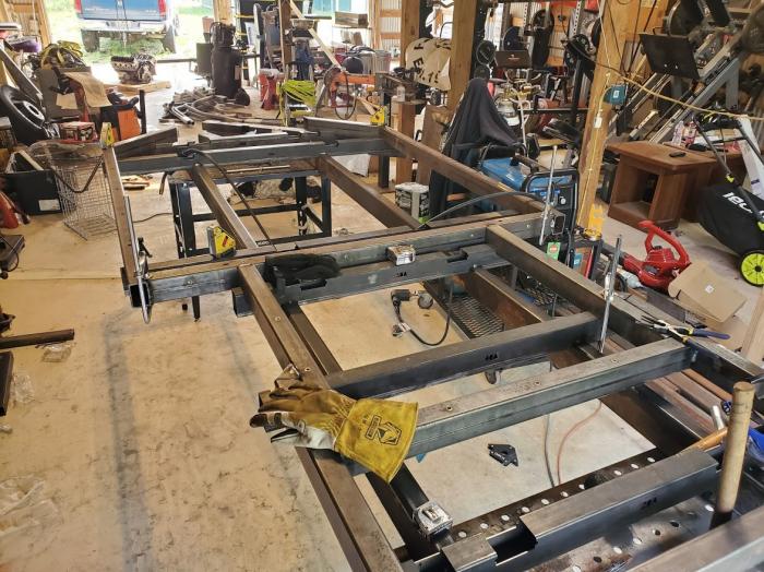

I assembled the subframe assembly first .
Once I had the subframe assembly put together, I began working on the chassis jig and getting it laid out properly. My Son came for a visit and helped with that part. :) this is the same kid in the first pic, only taller lol
once the jig was set, I began adding the pieces. Important note here, Each piece of the chassis is numbered and marked, notched and or bent. Which is a huge help.

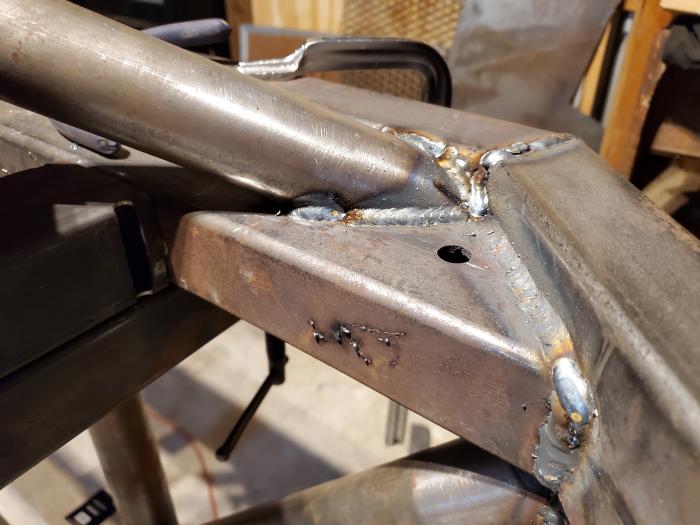

stopped a bit and joined this site and got a huge amount of help with my welding, for which I am forever thankful. Free beer and brisket for all... one day. Its been slow but I've been trying to do a little every day. Wife, Work, Chores etc keep me busy, something about too many irons in the fire.
Which brings us up to the current pics.
started fish plating this past weekend.
and that's where I'm at as of this writing. :) I have everything on hand needed to make it a roller. just some more assembly needed. :)

Olecoot
    Thu Nov 26, 2020 10:01 pm
    Somerset, Texas
I got a bit more done since our last visit.
My Buddy came over to lend a hand getting the subframe positioned correctly.
Subframe is set in place and tacked.. measure measure measure then measure again. :)
just burning more wire.
