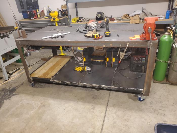

This is my second welding project, pretty happy with it for $30.... not including the vise of corse
- 20210624_191956.jpg (55.27 KiB) Viewed 5301 times
Run by a scrap metal shop or retailer and grab a drop of stainless tube/pipe. Grind a really clean spot on your table leg then weld the stainless to it. Use the stainless as your ground clamp spot. With a rusty top, you’ll struggle to get great grounds constantly, but welding the stainless stub to it solves that somewhat. The stainless won’t rust and will provide you a nice clean spot regularly.
I got several pieces from a pal who is a rifle smith. When he cuts the barrel blanks at the chamber, a 2” piece of 1.5” 416 works a treat. Did the same to my vise stand leg so I can clamp to it (frame and base are powder coated afterwards) and weld in the vise as needed.

I like that idea, and I could get some stainless from the fitters at work. That is currentlyoutside my skill set though. You probably need special wire and gas right?
just normal steel wire will be fine. its not a structural piece, it doesn't need to be a strong or corrosion resistant weld.Broc.houlbjerg wrote:I like that idea, and I could get some stainless from the fitters at work. That is currentlyoutside my skill set though. You probably need special wire and gas right?
just make sure the weld is big and long, so it handles big currents with no resistance.
You'd be better off waiting until you upgrade from the Flux Core box to a MIG (per your other post).Broc.houlbjerg wrote:I like that idea, and I could get some stainless from the fitters at work. That is currentlyoutside my skill set though. You probably need special wire and gas right?
