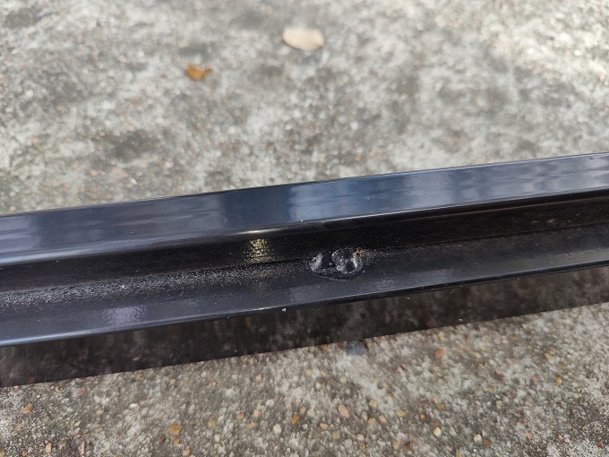

So the gate design has the 3/4" tubing on one side, aligned in the center of the larger tubing. While I had decided to weld in a section of the larger tubing within the existing stuff, I didn't see any reason to follow suit with the smaller variant by welding here:
And here:
I mean, why all that work? It's simply stitch welded (and "loosely" at that - where "loosely" means that there aren't many stitch welds):
So why not just cut the thing off in its entirety and weld on a full-length piece from the replacement stock (of which there is 12')? And so that is the direction we elected to take. Disappointingly when we cut off the smaller tubing, we verified what I had expected would be true:
Which is that the outfit that built the gate didn't use any weld-thru during their construction process. Rather, they simply mated the components together and threw on a few stitch welds. Granted, what you see is only surface rust and not much to be concerned with. However, being the particular individual that I am, I would have preferred that they follow a more thorough procedure. But maybe it's just me. I digress.

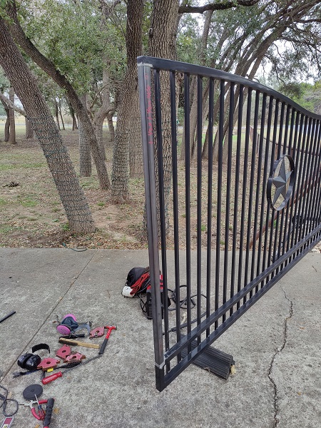

Proceeding forward ... we cut a section from the new 1.5" stock just a smidge long such that it would be a tad of a form fit. Installed that into position:
Welded, grinded and primered:
Then had to leave it there for the night. Unfortunately that is the condition in which the gate remains a few days later, as that very night I came down with something that left me unwilling to do anything I normally do; projects, whatever. Went in for a Covid test, still awaiting results. Don't think that I have that, but decided to verify anyway.

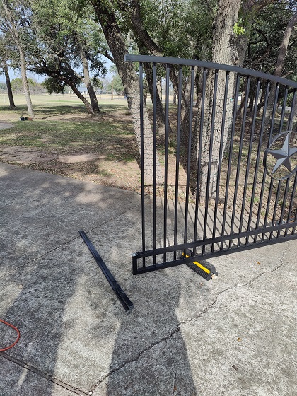

Well fellas I felt better enough such that an attempt to polish off the gate repair project seemed do-able. And so I primered the 3/4" tubing, installed its top cap (plastic) and then stitched it to the primary vertical member of the frame:
Then everything received a generous application of gloss black:
And we're done.
