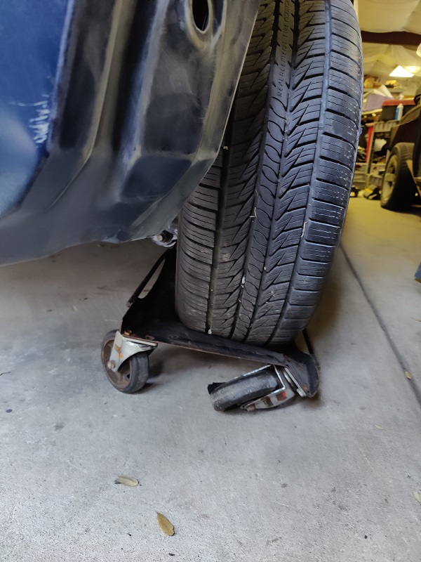

So I returned to working on the wife-eee's dream car build. I'm at the point in the process of body work/paint. I have elected to do that myself and will do so within my workshop. There is limited space therein, and so I need to have the ability to move the car around every which way necessary. That means car dollies. Easy enough, I happen to have four "heavty duty" variants. Put one of them under each corner and proceeded with the prep and painting of the inside of the doors and the door jambs. Began on the driver's side. Finished that. Went to move the car to the left in order to gain access to the pax side to do those doors/door jambs when those so-called "heavies" took a dump:
Given my chosen approach to laying down some color on the wife-eee's daily, I need a full complement of these critters. And so I paused the build in order to do a little fab work to bring them back online. Thought I'd share the story with the forum...

And given the HF tags that I found on the casters, it's little wonder as to where they originated. Having decided to just repair these instead of going-new, I removed the dollies from underneath the front of the vehicle and laid them on the workbench. Make note that I am in no fashion attempting a glorified restoration of these dollies. Hardly. They'll get a light touch of The Brilliance, but that will be the limit. So keep that in mind as we go along. And speaking of the limitations that I am imposing on this little side project, the rear two dollies are doing ok, so I'm not certain that I'll repair those at this time. Perhaps down the road. If they'll continue to function given the lower weight that they are being subjected to, then I'll leave them be for now. Note that both of the casters on the driver's side collapsed outboard, thus deforming the metal in that area of the dolly:
How effed up is effed up?
That's effed up. After removing the casters and tossing them into the lil' un's metal recycling bin, the first item on the agenda was the straightening of the body:
