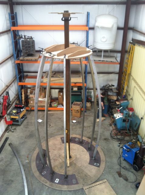

Here are a few pictures of this stainless steel art sculpture I am working on at work.
I have been getting some great feedback from others on some of the stainless steel
MIG I did to get this going. I will post more pictures as it comes along...

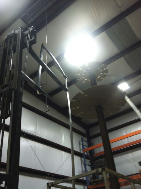

Here you can see this huge jig I made to secure it for assembly. The column
that runs in the middle is just for the jig.
Here is this arm attachment I made for our forklift to basically turn it into a crane!

Good Lord! Scaling from the background, that thing must be about 22' tall!
Can't wait to see what it becomes!
Interesting project you have going there Elliot, thanks for sharing it's creation with us. Looking forward to more updates in the future.
Better watch out there Steve. That first picture kind of looks like he may be building a "time out" cage for the greenies around here.
Damn!
Missed my guess by four feet.
Must be my ego... It always looks bigger to me.
Again, I can't wait to see what this becomes.
