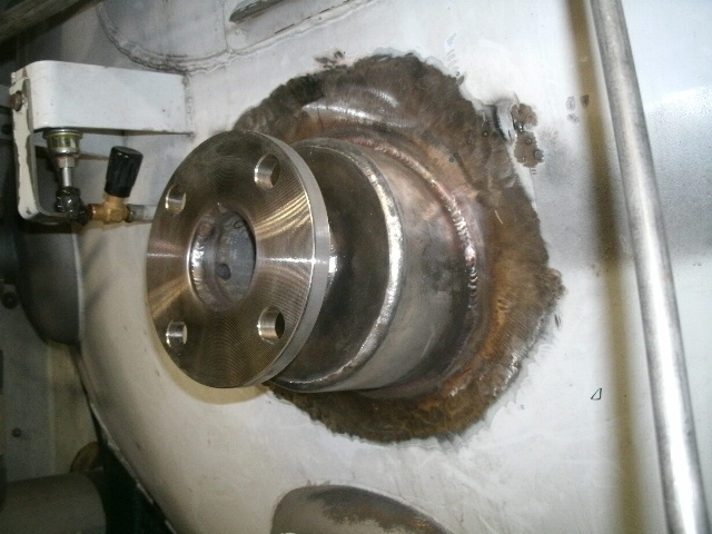

Well, here's the patch section. I got a near-perfect fit (to the boss' amazement). I fit it to be a butt joint all the way, since the material is 12 ga., then welded the inside first with an ESAB Miniarc 90i (it would fit through the manway and baffles). I got about 75% penetration.
In this pic, the welds have been back-ground to remove "sugar" and open the outer seam to the inner weld joint. At this point, I'm purging the inner to nitrogen and twiddling my thumbs. I did get about 2/3 of the outer welded before quitting time...
I had about 8 hours on the inside, and expect about 6 total on the outside.

Anywho... The repair passed it's first, and most basic test today. I pressured it to 25 psi and soap-bubble tested it. I had no doubt it would pass this one, but it's still "procedure". Next is to add helium (to about 1 psi additional), and "sniff" the welds with the mass spectrometer. No word yet on if there will be x-ray, but I sealed the tools I'd need for a repair in the vessel just in case (I have to re-open it for oxygen-clean procedures, anyway, but today realized I'd sealed my damn welding hood in there, too!). I just dropped all the power cords and the argon line for the TIG inside the manway, rather than dragging all that equipment out, just in case I should need to make a repair, but I was cussing leaving my hood in there!

No kidding!
Here's the way I spent my Friday:
Everything without paint on it is new. The six-inch sch. 40 is not "let in", it had to be coped to the rear head so I had to scribe a compound curve, fit and weld an end cap that centered on the 2" pipe, then fit and weld the flange (which the boss insisted I "stovepipe", meaning I had to install the spool that goes there, then tack the flange.) I landed within 1/16" of my layout.
I had to stand on my head for some of this, here's where it's located.
The original bell-cap that was in this location was leaking; It had cracked at (and through) the pipe, allowing air and liquid oxygen into the evacuated space.
