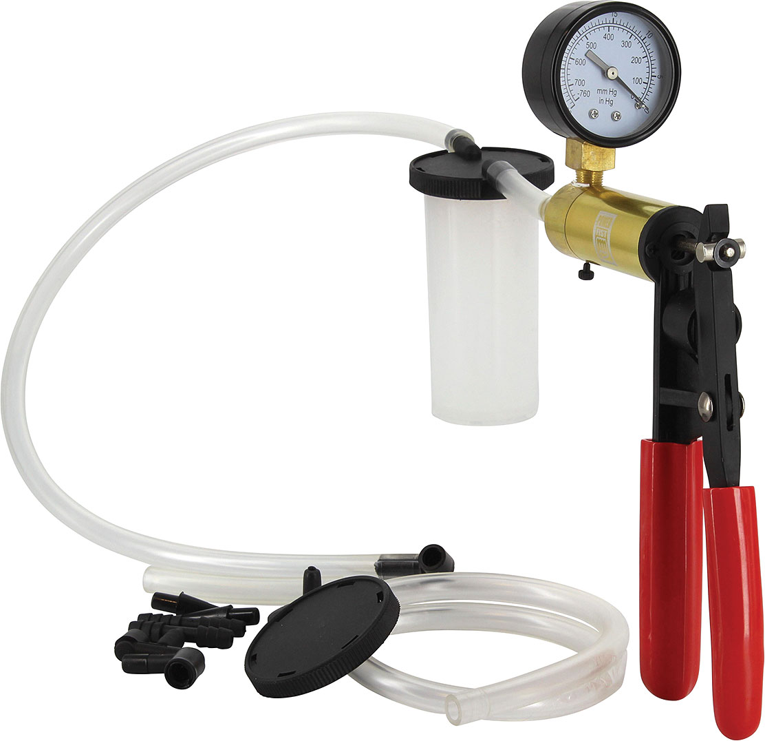

That's not it, either. Alot of new creative ideas. It's a brake bleeder pot. For many years, I've done brake jobs. My first was when I was thirteen. I've always had to have someone pump the brake peddle. I looked at every place for a bleeder pot and even an empty tank of any kind. McMaster Carr, Grainger, everywhere and the cheapest was around $150 for a small one. So I thought of a 6" pipe. Most places don't have remnants of 6" steel pipe. Cast, yes. Too heavy. Every place that did have 6" steel pipe, wanted me to buy 10' of it. So. I got some sheet metal, bent it around, welded it inside and out, made a top and bottom and then started to assemble.
Very astute, Alexa. I thought about that. Since the tank is sealed, there's no way to retrieve the valve stem. Or is there? If you notice, the filler plug is right next to the valve stem hole. If it does drop in the tank, I have a long 1/16" wire to wrap around the valve stem, bend it in a u-shape and feed it thru the hole and grab it with plyers. But, that's not one of the problems I'll have. When I go to weld the top on, that metal is gonna get hot! It might melt the rubber on the stem. What I'm gonna do, is get a small damp towel and place it over the valve stem. It should keep it cool enough while I weld. Also, I can cool it after after one or two passes.
I'm gonna try to make the reservoir lid today. Flat lid, same thickness as the top, 3/16", square, 3"x4" with slots, about 1/8" wide, cut in about 3/4" from the side. That's for the tightening chain. There's a fitting that I'll weld on the top where that brass inlet fitting and tube go. On the underside will be a rubber seal. If I finish the filler lid today, I'll post a photo. This is something that I've always wanted. I do alot of brake jobs. It's a great way to save money.
I forgot to mention. The top will also have a fitting for a pressure gauge. That's where most of the disagreements came in. Some say about 20 to 30 lbs. One guy at Haps said 100 lbs. Are you kidding? That would blow out the seals!
I'm have to assume that every car is different. I'm gonna start with 20lbs. and see how that works and go up from there. The fluid should stream out. Kinda like a water dispenser on a fridge.
Total cost for everything, less than 40 bucks.

If you're reverse-bleeding, from the caliper bleeder up, 10 PSI will be plenty. If you're "forward bleeding", from the reservior down, 5 PSI is more than enough.... I've done it on gravity (siphon) alone, on ABS, if the system wasn't compromised and I'm just changing calipers, or cylinders on drum brakes.
Forward bleeding is the better method for purging new calipers and flex-lines. Reverse is better for "upstream" components, like proportioning valves and master cylinders (in my experience).
I won't promise this is true for every system out there, but it's worked for me on the most common vehicles.
So I was pretty close with the "pressure-lubricator" thought...
