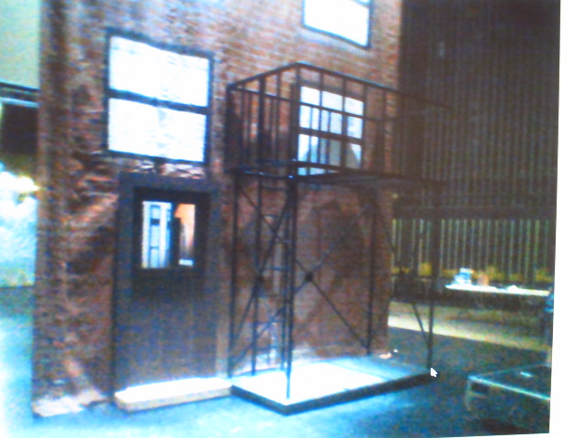

This was something I made for an awards show, it was combination scenery and a practical unit. It was a fire escape that also doubled as a DJ booth. The whole unit was 11 feet high, a 4 x8 footprint and had to roll on and offstage with the dj on the top level. It also had to look like a fire escape because it sat in front of a building façade for one of the scenes.

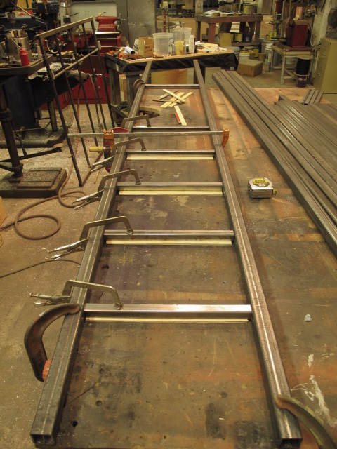

I made the whole thing out of 1 1/2 and 1x1 square tube, both 1/8th inch thick. Since money was tight, I used something called "mill surplus", that is, pieces from the end of the mill run that may have been a little short, maybe a little warped. It didn't matter much to me, I was going to cut it all up and square it anyways and it cost less than regular square tube.

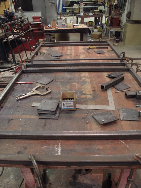

Since the unit was 11 foot high, it wouldn't fit as one piece into the truck, so I made the legs removable by welding in some square 1/4" plate with uncoated nuts welded to it to receive the leg bolts. The cross bracing was all bolted on too.
The first picture is the ladder layout, the second is the lower deck layout and the 3rd is my receiver plate for the leg bolts. These were on both the top and bottom decks, and the legs had a similar piece welded on each end but without any nuts.
I'll post pictures of how the whole thing came out in the next post.

Here's how it turned out while we were setting it up in the shop. We had to use a chain motor to pick the top deck up to hold it into place while we bolted everything together. I'll have pictures of how it looked on stage when I get them out of my phone.
There's also a picture of the plates being welded to the legs. On the leg plate, I drilled out the holes to a much larger size than the 3/8ths bolts. Just in case something didn't line up exactly like it should, there was a little slop.

Here's a couple of pictures as to how it came out. This is under work lights, not actual show conditions. if this were show conditions, the drop behind the fire escape would have been weighted down to stretch it tight.
