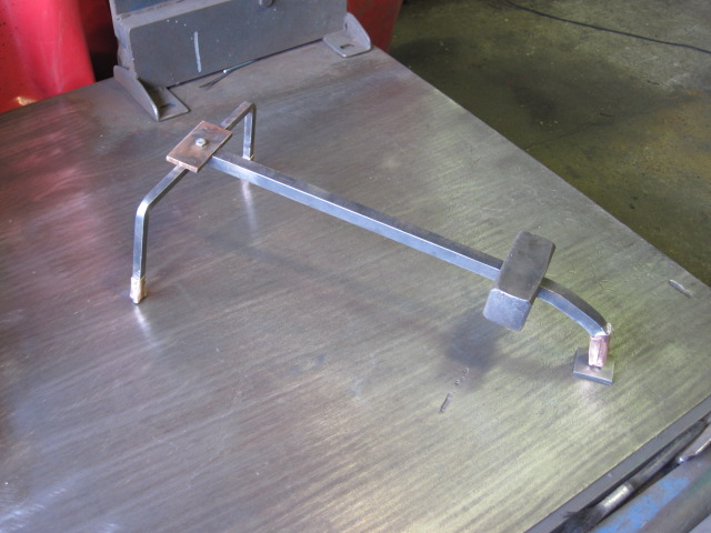

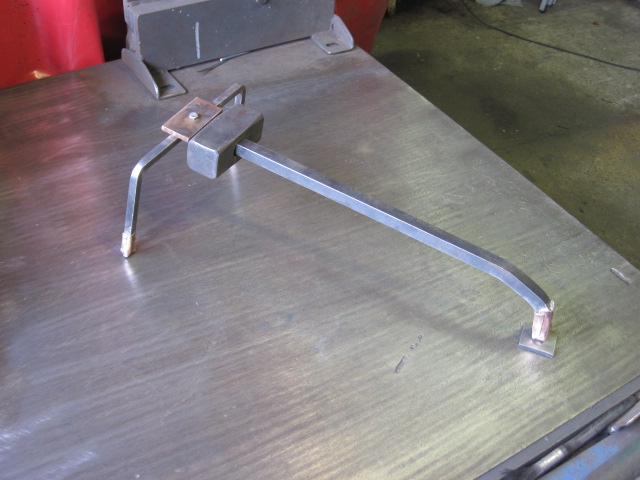

Ok - slightly different outlook on the 3rd hand thingy ! I'd never worried too much about it , but recently when altering a mirror finished stainless steel part it arced badly on the bench & made me say " DARN " ! so the hammer head was laying under the bench as was the 1/2" & 3/4" square - I figured making it touch at 3 points would be naturally more stable & the hammer head can be slid up & down to excert more weight if needed - the feet are rounded in 1 direction but flat across giving more choice - their clad in copper sheet to improve conductivity - I also bolted a bit of 1/4" flat copper on to "light up on" after grinding the tungsten as I manage to sweep them off the bench otherwise.

That's sweet! I like the sliding weight.
Do you have the copper bonded to the steel in any way? Solder, or something?
Yes- the copper is soft soldered to the legs for conductivity - but could be changed if necessary.

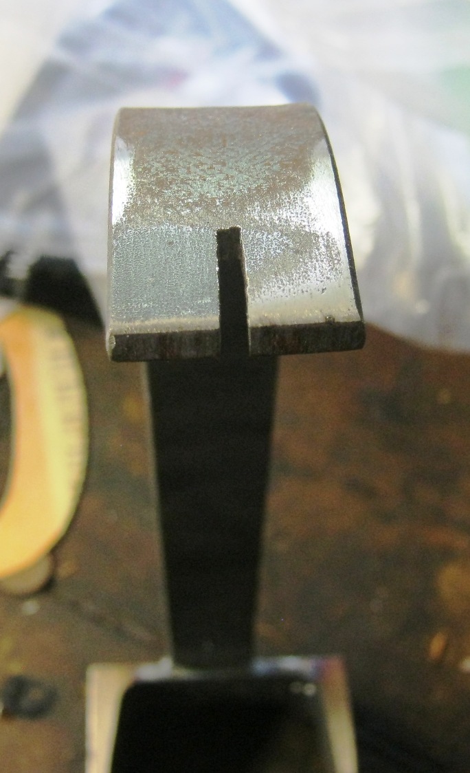

Here is one I made last winter with a sliding weight -
The tip and ground faces on the round tubing are copper building wire that were tig welded directly to the steel , then turned down in the lathe . No more arc marks on work , big help for sure .

When I did mine, I noticed they would still make small black arc strikes on my aluminum. Jody showed the same and used silicon bronze for the ends I believe.
I did not have any so I used house electrical wire and tigged some copper on mine
