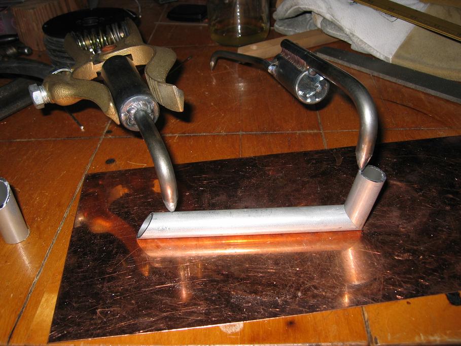

jakeru
    Sun Apr 25, 2010 3:30 pm
Thanks guys - they have already indeed come in handy for me!
Check this out... I had to tack weld some thin, miter-cut aluminum tubing. These little "welder's fingers" let me set this up perfectly, nicely grounded, with great access for vision, torch, and filler rod, in about one minute.
I am finding them real handy for quickly and effectively grounding parts too. (I got lucky that my ground clamp latches onto one of them quite nicely!)

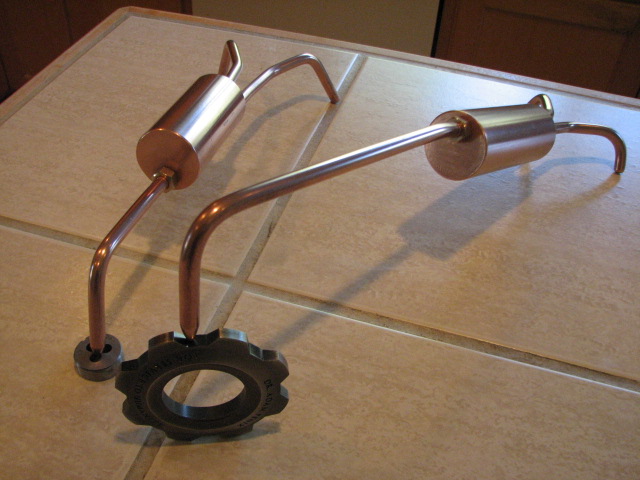

I went with a welder's finger system.
System? I should be in Marketing. After researching what other folks have made, I decided to make something I could 'adjust' a bit depending on a particular job's needs. A quick look in my metal stash showed no useable scraps (culls, drops, shorts- pick your term) for weights, legs, etc.. So, my options were wide open.
Starting with Platinum at the top of my "metal weights" list, I scrolled down to the first metal I could remotely afford- copper. I skipped lead. Copper's not cheap these days, but it's down a bit lately and it's easier to cut, drill, thread and bend than steel. Shiny is good too. Being a 'Gentleman Welder', shiny is always a plus. I also figured the copper would help avoid marking my projects with arc strikes due to better grounding.
So I got onto OnlineMetal.com's web site and selected some 1 1/2" and some 5/16" rod. 2" rod was really expensive. And by ordering a 3" piece and a 4" piece of 1 1/2", I didn't have to cut them myself. It cost me like $1.73 per cut. A bargain.
A word about OnlineMetals: These guys and their website are great. Fun site, lots of information, good selection, reasonable prices, easy to order and deal with. The only downside applies to all online metal suppliers (and everything else for that matter)- shipping costs. I finally got a break. They're in Seattle... only 30 miles from me so I could Will Call my stuff. And a good excuse to visit my favorite burger joint nearby.

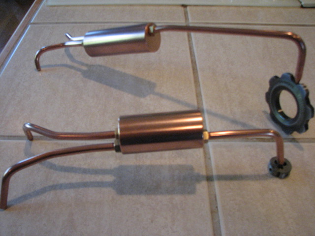

I can adjust the width and length of the legs, change points, raise or lower the weights and points, etc. If I need a special shape for the legs or point, it's pretty quick and easy to whip something up with the leftover 5/16” rod.
I ended up paying about $60 for materials & gas + $10 for burgers. Not a cheap 'system' initially, but cost is low to add components. Currently, 5/16" C110 (ETP) COPPER ROUND ROD is $4.28/foot. Steel would have been cheaper, maybe by 1/2, but not as heavy per square inch and, as mentioned, harder to fab.

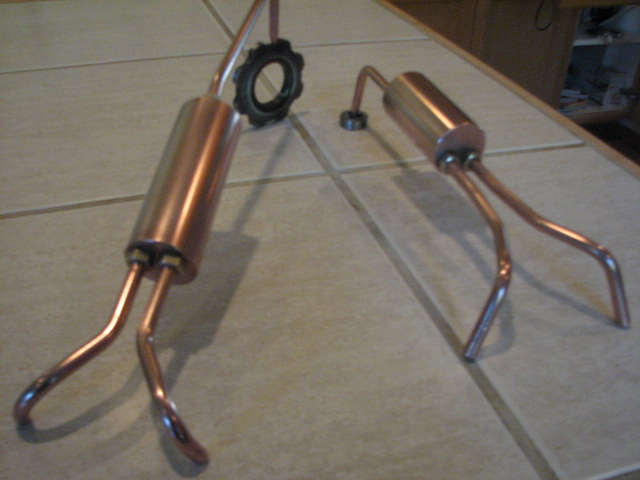

Fascinated with the "third hand system" and would like to have a go at making one for myself. My question is how do you weld the stainless steel nuts, (I presume they're stainless) to the copper rod as per picture on the website?
Cheers
Rastas
RonSII
    Mon Sep 17, 2012 5:53 pm
Hello and welcome Rastas, I am new here myself (been lurking for a while)
I am guessing that the rod is threaded long and the weights are drilled and tapped so the nuts are just jamb nuts

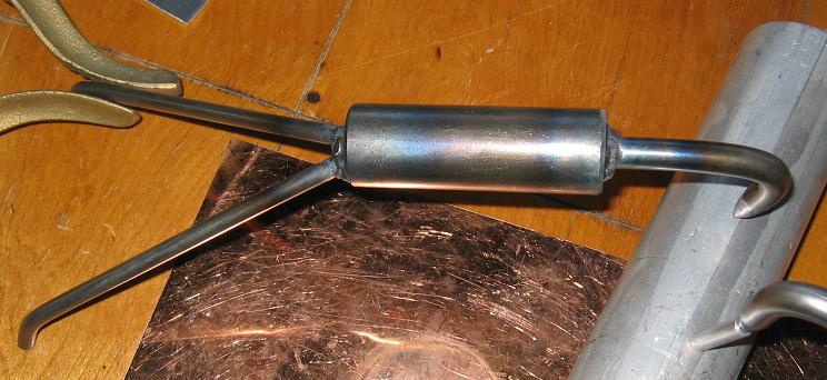

rahtreelimbs
    Mon Jun 14, 2010 10:39 pm
Threw these together the other night .....all stainless.

Rastas-
I know it's only been 3 years since you asked (Geeez. Wish I'd been notified of your question), but for posterity...
RonII is/was on the nose. Large copper bars are tapped and the rods are threaded so I can change lengths, angles, etc. Hex nuts serve to lock-in position, which maybe makes the project more suitable for a machining site. :D
As a long-term review, the fingers have worked out great. I use them regularly and have made a few more, um, arms from the copper leftovers for special situations. Being a Gentleman Weldor and, apparently, also a Gentleman Machinist, I can fuss around with such things. Welding would have been faster, but, then I'd have several bits instead of a 'System'. Hope you see this before 2018!
