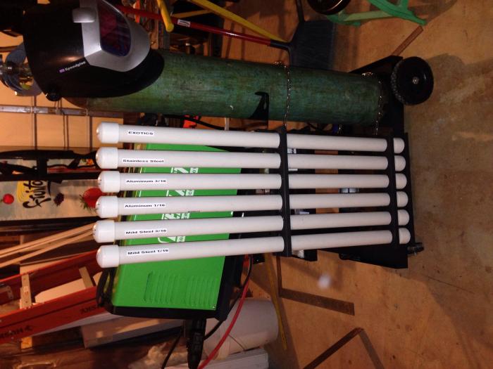

Here are a few pics of my modified Harbor Freight welding cart. I bought an Everlast Powertig 185 (2014 model with duel voltage, stick/tig function and dinse 35 connectors)
After tinkering with it for a little while I bought the CK FlexLoc torch and am happy to say I am pleased with both the machine and the torch.
I lengthened the top tray on one side, added tabs to locate the 125 CF Argon bottle better and then added the tube holders for the PVC pipe to hold
Nicely done.
I've wondered about using 36" tubes for filler rod... over time, won't the tube fill with shorter rods that you can't reach?
Welding carts seem to be like trucks - infinitely customizable. There are some pretty amazing projects out there.

My idea was to put a pin through the tube a little off set and bend a hook on the end of the short rods so the are hung at top.

Ah, that seems like a very practical solution! I was trying to picture creative ways to get access to the bottom of the tube...Marc Godwin wrote:My idea was to put a pin through the tube a little off set and bend a hook on the end of the short rods so the are hung at top.
Can someone comment on whether it's important to keep filler rod in a sealed container? Does exposure to moisture in the air have any effect on them? The 10# tubes they come in don't seem very airtight.

Id say that those tubes will protect your rods just fine. Especially for home use. If they are sitting for any length of time, the copper coated steel may go dull, the al will get its oxidation on in, these two can be "fixed" by a light rub with scotch brite, before use. (maybe acetone as well for the al) but the ss will continue on being awesomely corrosion resistant .

Or shop is not climate controlled, on the humid gulf coast, and we store our rods "open", to little ill effect. As long as they don't get directly wet, even the carbon steel stays shiny quite a while. I only worry about cleaning the rods if they're obviously discolored, or if it's a critical or coded weld.RichardH wrote: Can someone comment on whether it's important to keep filler rod in a sealed container? Does exposure to moisture in the air have any effect on them? The 10# tubes they come in don't seem very airtight.

Admittedly, those tubes, capped, make for a neat appearance in the shop.
