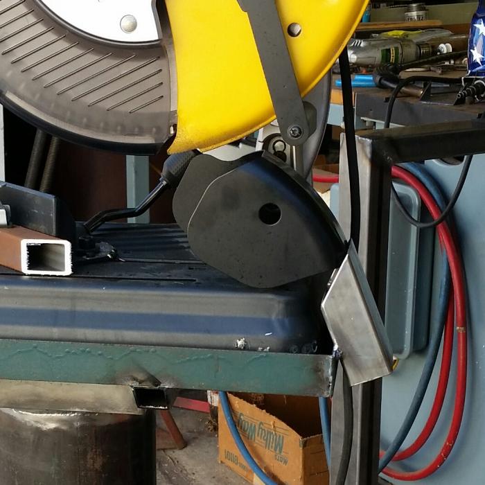

cutting with abrasive chopsaw contributes a lot of mess in my shop..so i came up with an idea to contain the spark and the dust as well..
3x1 channel bar.welded together to form a rectangular tube..

test shows almost 90% of spark goes through the trap..

collecting dust..
just simply flip open the dust catcher..
see how effective it is..

This was such a good idea I added a quick one to my saw!

Guess I'll hang a tin can on mine and see how it works, or just ty-rap a bag on it...

It was a last minute re-purposing of an old bed frame... suddenly changed my mind from plate to angle iron for the saw and that's all I had...

Thanks guys! Hey glen you have a nice saw there..it is still on my wish list unfortunately prices of dry cut saw here in the philippines are way too high. :cry:
