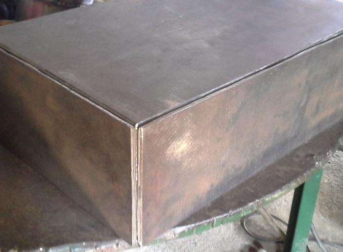

Well, it`s all welded and there is almost no warpage. I welded the corners first and then welded the center part of the longer side then moved to the shorter side. I welded those welds from the center out to the corners and moved diagonally for the next weld.
Then flip it over, repeat and eventually weld the rest on the longer side moving to the corners. That`s all folks :D

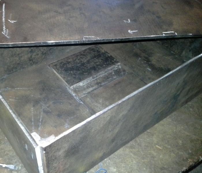

I'm sure it's just my eyes playing tricks, but in the first photo it looks a bit like a crack near the top of the vertical weld. :ugeek:

xwrench wrote:I'm sure it's just my eyes playing tricks, but in the first photo it looks a bit like a crack near the top of the vertical weld. :ugeek:
I will back you up, looks like it to me as well.

If you mean the highlighted area, it is just a part where the weld stops and the backing is visible. Sorry to burst your bubble...

I think they're talking about to the left of your circle. It looks like the slag may have puked down over your other weld.

It`s just metal poured over from the heat. It was grinded out and welded over with no problem whatsoever. The part under the bulge on the left is actually millscale. Should of grinded it before welding and use 3/32" instead of 1/8" but wanted to weld a bit hotter on the corners. A crack that size wouldn`t of disappear after using flap disk on it just to deburr.

Don't take this crack question as your project is bad. Looks very good to me. Just thought that this looks like a crack. Pic is blurry but this is what I was referring to.

I never thought of it that way. Back to the crack :) it is actually a millscale, but the picture is not of good quality so maybe that`s why it looks like it. As I said earlier, crack like that doesn`t disappear after using flap disc on it just for deburring the edge. The tie in wasn`t perfect so there was a little undercut on the sides but nothing major since the weld is already overdone for it`s application.

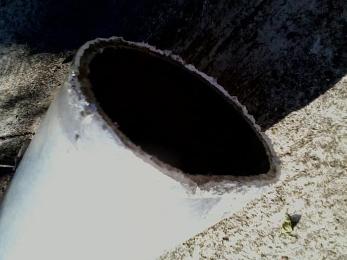

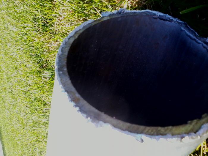

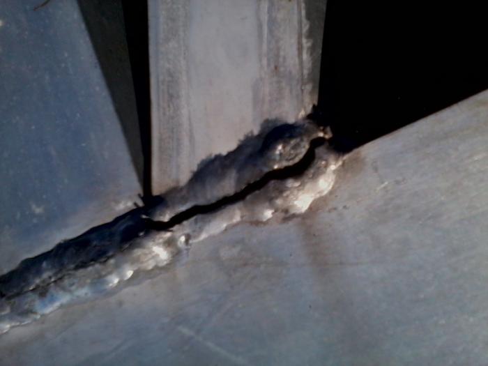

Since we are already talking about weld cracks here are some pics of cracks on aluminum gates for track&field. The wind caused the gates to break.

Looks like weld material just sitting on top of everything.
dsmabe wrote:Looks like weld material just sitting on top of everything.
Agreed! Serious "lack of penetration" issues. Those welds all appear to be (poor) cap/crown welds on metal that was not prepped for the weld.

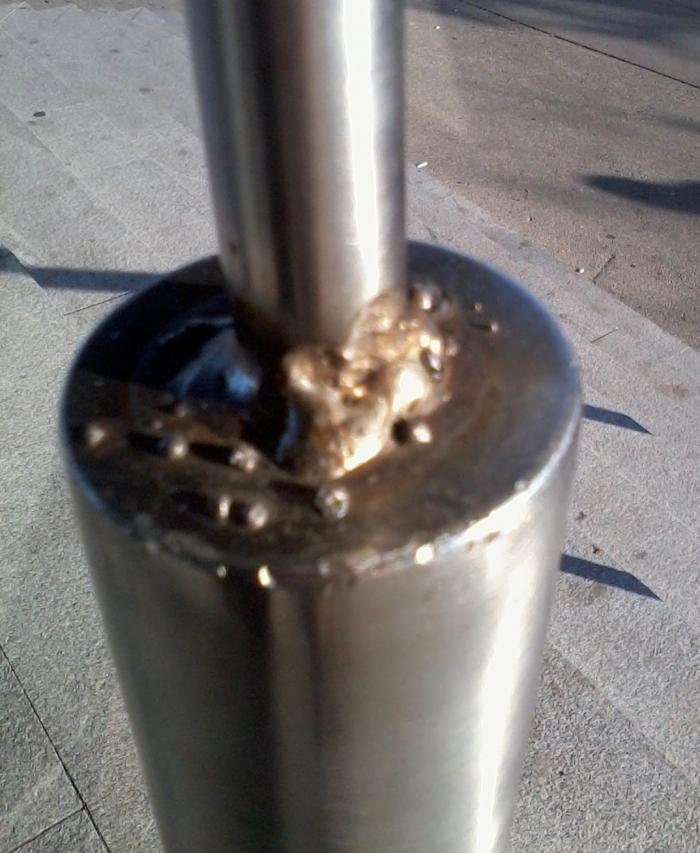

I just like to take pictures of welds that are interesting to me. Sometimes you should just use stick for stainless:

Owr wrote:I just like to take pictures of welds that are interesting to me. Sometimes you should just use stick for stainless:
Sounds like a good hobby. I'm always scrutinizing welds when out and about. Drives my friends nuts!
