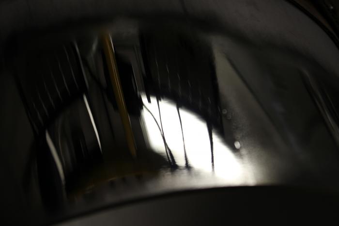

I use tooth paste as a polish. and... it smells minty fresh.
It works great on plastic car headlights, chrome wheels, etc.
You can even use it to fix up those scratched CDs and DVDs.

WerkSpace,
I've done that several times. It works great, but it doesn't seem to last. How do you treat them to resist UV?
Well, they make UV blocker treatments for eyeglass lenses and safety glasses, so yeah, "kind-of". There should be something available to treat a freshly polished plastic to resist UV.WerkSpace wrote:Sun screen?

Hey Otto.
I'm no ace but I have been called something similar.
Try this:
http://www.autopia-carcare.com/headligh ... MFtWS6y7KA
I don't know how long it lasts because my truck is only 18 mos old. Time will tell. The sealant is intended to be used each time you wax or seal the vehicle (3 - 6 months). But nothing lasts very long parked in the sun.

^ if you use that every time you wash it from new, you won't even have any headlights left after a few years.
In essence, don't do that.
Get something like this, since yours are still fine. http://www.xpel.com/products/headlight_protection.asp
