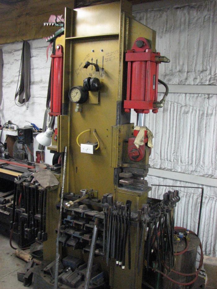

I used to make a lot of Damascus steel for knives I made. I made a press to forge weld under and use it for general forging work. Will add in a pic of it. Used a 4" cylinder on one side and a 6" on the other. This monster would press a 1" wide x 6" long x 6" tall Damascus billet down to 2" wide without any problems - of course this billet was around 2200 degrees at the time too.
- forge press2.jpg (103.3 KiB) Viewed 30412 times

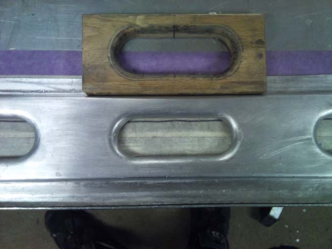

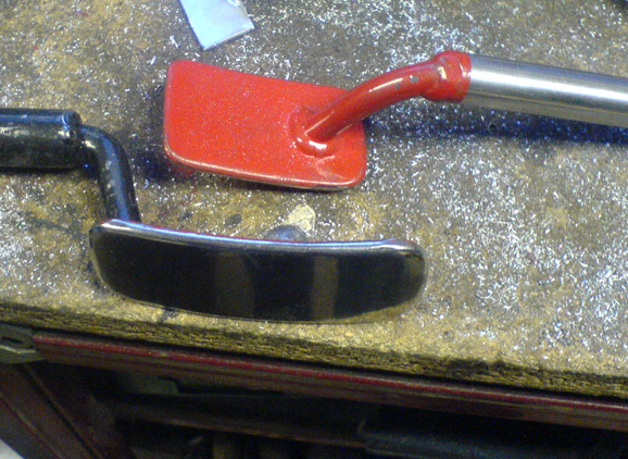

I dug up some pictures of some simple tools I've made

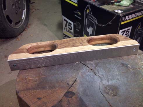

Body file holder, the file lies on a "stump" used to shrink metal on
Some various templates for recesses or dimples.

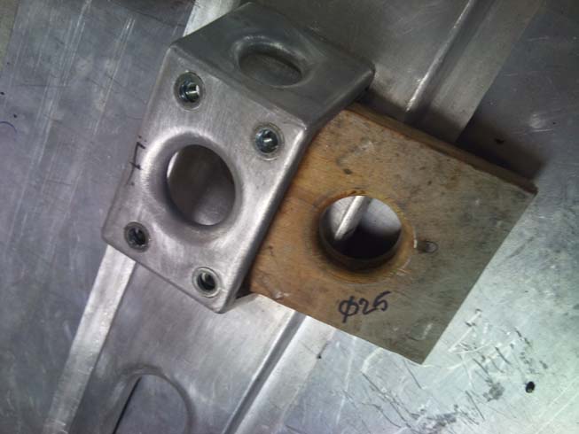

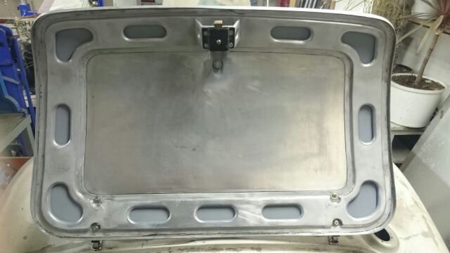

Some oak, jigsaw, holesaws and a wood router is everything needed
They were used to make this

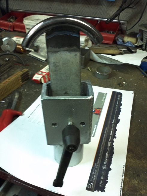

Tool for tipping edges (can be shimmed to take different sheet thickness)
- DSC_0015.jpg (43.19 KiB) Viewed 25879 times
- DSC_0085.jpg (53.43 KiB) Viewed 25879 times
- DSC_0086.jpg (45.43 KiB) Viewed 25879 times
- DSC_0088.jpg (50.35 KiB) Viewed 25879 times

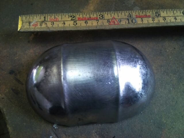

That's cool! You doing hot work with them, or is it all done cold?

Thanks gor the kind comments.
I mainly work cold but sometimes, like with the parts for the dragonfly, I need to anneal when it work hardens.
The size and degree of shaping would make them crack otherwise
