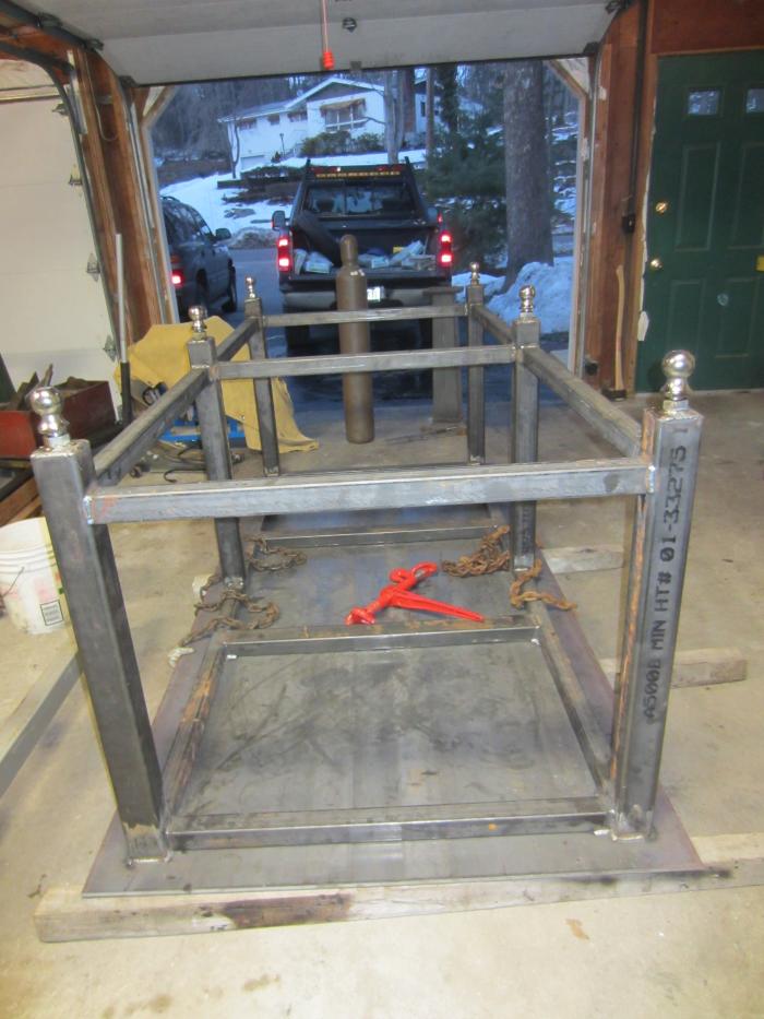

]somehow I managed to snap the arm of my backhoe Some backracks I made for an f350made this small bin to hold my poker and shovel for my wood stove but I think it would serve better as a battery box or something on my 53 ford. I was dying to try out some aircraft style rivet on a projectWhen we moved to a house with a 2 car garage I decided to make this larger table 1/2" plate with 3x3 1/4 wall uprights, I used an idea from Kevin Caron on youtube for the feet. Trailer balls to level the table out and also to lower it onto caster to move it (if need be) Here's a 1940's Lincoln SA200 I overhauled years back, I wanted to keep it but just had no use for it. Aluminum trailer ramps, nice and light
Nice work! I like the trailer ball idea. I gotta know...how did you break your hoe that bad? Oh Welcome to the forum!
