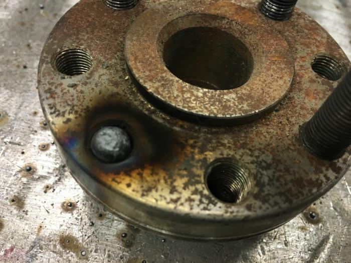

Hi,
I have a motor which has a crankshaft with broken flywheel bolts. One guy installed flywheel with too long bolts, and flywheel was loose. Then he drove it until only one bolt was holding the flywheel! The others were sheared off. Some quite deep, some on the surface.
I have removed bolts from the aluminum parts by welding a nut with a MIG, but never from the steel.
I think that the ones which are on the surface are easy to remove, but I would need some tips how to remove the ones that are very deep? I'm afraid to weld to the threads. I can also use TIG, but I think that the MIG is better in this case?

FORGET mig for this.
The bolt size is M10 x 1mm and those are 12.9 grade, but I could drill those easily with cobalt drills. I don't have left hand bolts or thread tap. That sounds a good idea though. I'm really afraid to damage the threads, since then it makes this project much bigger and more expensive. I have some oll pressure meter adaptors, and one has M10 x 1 mm thread. I was thinking to use that as a drilling guide to get the hole exactly centered. As the bolt head is not straight, and it is hard to get it centered. But first I have to find some left hand bolts and taps.
Today I had some spare time, so I tried to remove the easiest one. But clearly my MIG doesn't make the initial weld so strong, and I didn't have success. I tried to weld a washer and then nut over it, and finally just a nut, but the weld always broke. I have other better MIG, but it has stainless steel wire and I didn't want to use it because the bolt would open easily.
I made some aluminium rolls which I could put inside to protect the threads, but I'm not sure that would it withstand the heat if I would weld the bolt with TIG.

I tested to remove one "snapped" bolt. I cut the bolt with a grinder so it would break when it bottoms out. I tightened it quite tight before it broke. The head was about 7 mm deep.
The I put the aluminum protector inside and started to heat the bolt with a TIG. Well, the aluminum "protector" melted less than a second
I took it away, and used 60 amps to melt the bolt. It was maybe a bit too much. The I just added some material and raised it up. That was dead easy! When it was high enough, I welded a nut and let it cool down. The I just turned it with a wrench, and it opened like it hasn't been tightened at all! Very easy job!
No damage to the threads.
So it seems that I could try the TIG welding method to my motor, but It just needs much work to move the motor to my friend garage. I'll leave that as a last option.
