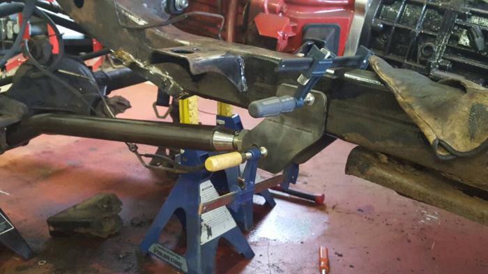

    Fri Nov 14, 2014 5:13 pm
We are working on the suspension design
Sent from my SAMSUNG-SM-G890A using Tapatalk
Jeep Cummins transplant specialist
Started welding the driver side link
