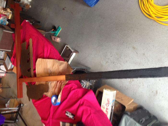

Wooden mailbox post was rotting out so decided to practice with my new Hypertherm 30air and make a new one. Posts were band saw cut and bears were plasma. Welded with a original version Miller 211, .030 ER70-S6 wire. Did not use Autoset but settings were per the chart. 1/8" steel, sprayed cold galvanizing paint inside before I put on the end caps and painted outside with rattle cans. Covered part that will go into ground with asphalt sealant for roofing and gutters and let dry. I could not decide if I needed small air holes in the tubing would be better or worse for preventing internal for internal corrosion so I put in small holes just under the "T" joint in the back. Either way will probably outlast me.
- Installed
- IMG_4774[1].JPG (67.28 KiB) Viewed 2606 times
- Bear 1
- IMG_4725[1].JPG (42.74 KiB) Viewed 2606 times
- Bear 2
- IMG_4724[1].JPG (41.24 KiB) Viewed 2606 times
- Ready for install.
- IMG_4722[1].JPG (47.14 KiB) Viewed 2606 times

Thanks for the comments. Hoping it will last a few years. Tried to put it back far enough to not get beat by the kids or the snow plows. I don't think that protecting your mailbox is a viable legal defense, even in Alaska. //Shipj0//

C. Livingston. That is a cool mailbox. I'm thinking it would win against everything but maybe an M1 Tank. Kym / Sedanman: Not sure I needed a structural bear but made sense when I built it. Good eye that you caught that design part. Was going to do the same with the back bear but it didn't look balanced that way and kind of looked like the back bear was trying to sniff the front bears butt. Had to lower it far as possible to try and get away from that. My first "art" project, was fun to see how it came out.
