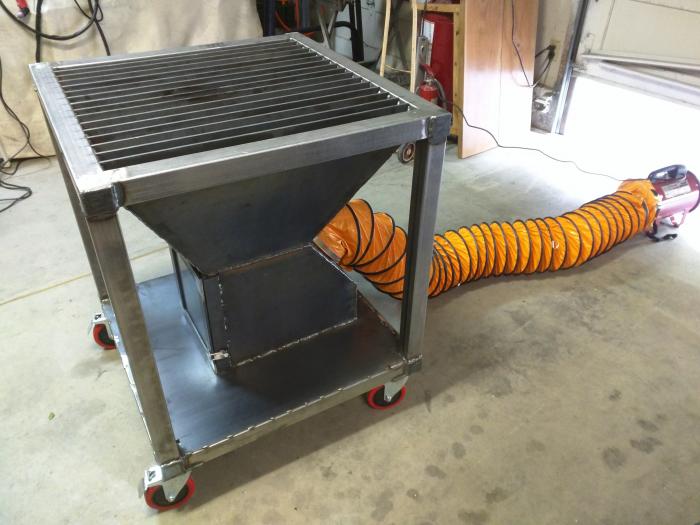

I recently finished a version of Jody's downdraft table design. Works great for plasma cutting and even capturing flux-cored welding smoke. I don't have a fume extractor so I used Jody's suggestion with a cheap fan and duct from HF. I'm learning how to weld so my joints look like "Fido's you know what..." The sheet metal is 14gauge and the 2" tubing is 13gauge (left over parts from a table base). Debris falls into a sheet metal drawer behind a hinged door on the front of the table.

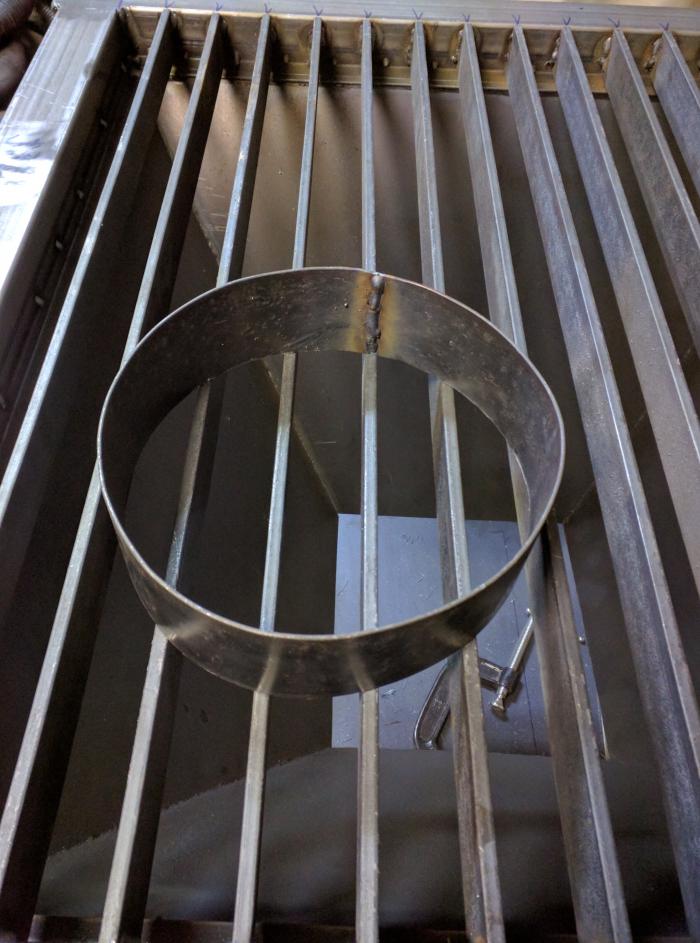

One of the many memorable challenges was making a flange to attach the hose to the box base. By trial and error, I used a ball-peen hammer to curve the sheet metal into enough of a ring shape.

Thanks! If I could change one thing, I would use thicker wall tubing or angle iron for the top frame.

I do not care what your welds look like in this case that is a pretty nice and square build. That is the first half of the welding right there. The fit up and cleaning. Everything after that is useless without that skill which you have down pretty good for a beginner.

I don't know how to measure the actual pull at the top of the table. I did do what Jody did in his Youtube video with lighting a paper towel placed at the top of the table. To my delight, all the smoke and fumes were pulled down but as the paper burned and drifted down to the cone, to my horror, I watched all the ash and sparks get blasted out of the end of the fan onto the driveway. Later on I successfully tested the downdraft function with welding flux core wire, I videoed the event and uploaded a screen shot in the first post. I need to test it with stick welding too. I didn't have to wear my respirator but in the future I probably should. Honestly I think this ventilator fan 0.22hp is just barely enough to get by. I've been contemplating removing my 1.5hp blower from my cyclone wood dust collector to use but then again maybe it would pull too hard and blow metal dust onto the driveway. If you want to me try some other tests for the downdraft capability let me know.rahtreelimbs wrote:How much downdraft do you get?
Tonight I clamped on some scrap sheet metal pieces from an old Sears radial arm sheet metal stand to help deflect grinding and cutting debris from angle grinding and abrasive saw cuts. Seems to capture 97% of the sparks but the garage really stinks after making a single cut. I think the abrasive blade glue burning makes it smell bad.
