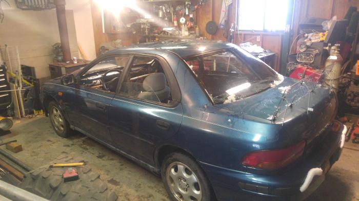

So I got a call from a gentleman about building a race car. We talked he told me what he wanted and sent me a copy of the rule book. After reviewing I decided why not it looked like fun. So here we go the start to the 24 hours of lemons impreza roll cage.

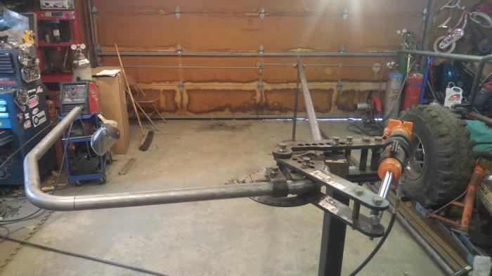

After getting the stock seat out and scraping the junk off the floor. And breaking out the tube bender. And 2 solid days of work things are taking shape. This is day 1

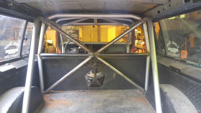

This is the pic of the jeep cage I did. No holes in the floor little tight welding but it was built in 3 sections then installed back into the jeep already painted I just had to clean up where I was welding. Then I added the support tubes after it was installed. And it was done.

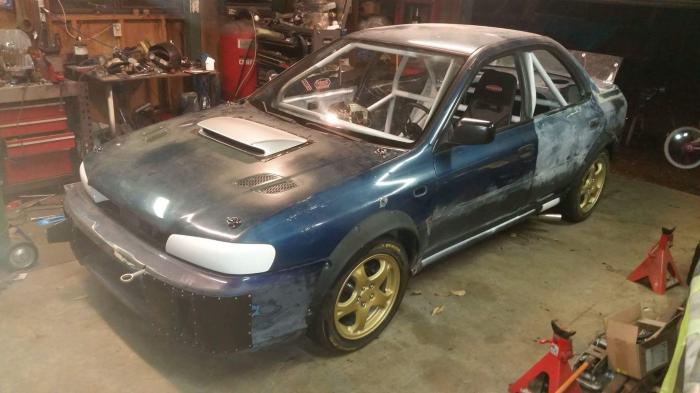

This one is complete and suppose to be on the track this weekend. But I haven't talked to the owner yet to see if it made it. Last I know it was at the tuner but having problems.
