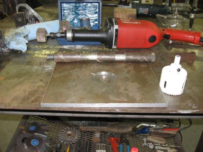

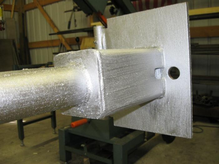

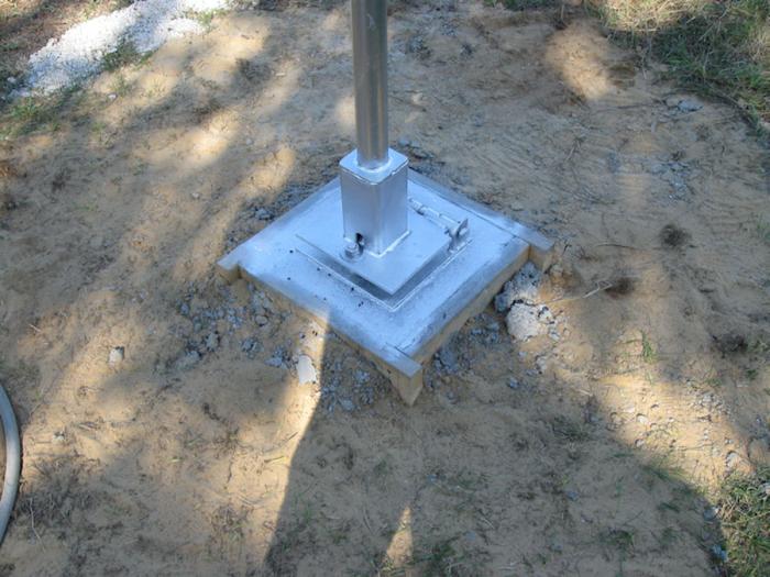

A few years back I wanted to buy an aluminum tilting flag pole until I priced them, just the cast aluminium bases were over $300. I called my friend who owns a weld shop and asked if he had any salvaged 2" pipe, he said he did and let me have two full lengths for $25 a piece. The 3/8 plate was another $25, the 12"X 40" galvanized culvert footing $25?.... the rope trolley and ball at the top was $50 to the house. The weld was ground smooth so it wouldn't tear up the flag. I used automobile heater hose I had to fill the gaps between the pipe nipples. The bottom plate has a 4" X 40" long piece of I beam welded to it that goes down in the concrete.
