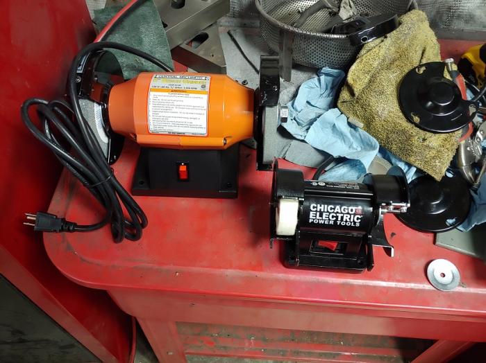

So what was the additional cost you ask? Well in the end I purchased two grinders. But as usual I'm getting ahead of myself. This was the first one:
It is the Harbor Freight Chicago Electric 3 In. Mini Tool Grinder With Buffing Wheel. SKU #94071. This was the grinder that I had originally planned on using. Note that by the time I snapped the above picture I had removed the side walls of the wheel housing. Ergo, it doesn't come in the configuration shown above out-of-the-box. On the whole, it met expectations, though somehow it was "just smaller" than I had anticipated. As in "way smaller". Don't know how that happened but ... anyway. So I powered it up to verify operation. It was relatively quiet. The shaft however was a tad concentric and thus the rotation was not uniform about the lateral axis. Both the stone wheel and the buffer wheel had lateral movement which contributed to a slight vibration and a tad of noise. However given the cost and source this was not unexpected. Thus I'd have to say that, again, this product lived up to my expectation.
The first thing I did was to remove the stone grinding wheel:

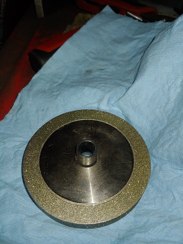

I then compared the stone wheel to the diamond wheel. There is a width difference:
And as one of the reviews for this diamond wheel indicated, it is a tad larger in diameter than the stone wheel that comes with the grinder:
- grinder 3.jpg (40.89 KiB) Viewed 9715 times
- grinder 4.jpg (67.23 KiB) Viewed 9715 times
av8or1
- av8or1
Location:TEXAS

That said, I decided to press ahead with the investigation. I installed the bushing from the stone wheel into the diamond wheel:
Since the diamond variant is narrower than the stone one, that resulted in a bit of stick-out of this bushing:
Which was disappointing too, but I knew from having taken a look at the outer flange that due to the shape of that flange, this stick-out wouldn't be an issue. And sure enough, it wasn't. Wiping the eyebrow on that one.
- grinder 9.jpg (209.84 KiB) Viewed 9724 times
- grinder 10.jpg (31.33 KiB) Viewed 9724 times

So this particular grinder product is titled CENTRAL MACHINERY 5 In. Bench Grinder, SKU #94186. Because Oscar had mentioned that he uses an aluminum oxide grinding wheel and there was a 5" one displayed just above the display model, I decided to take a punt on that too and bring one of those home as well:
Heck why not? I had a coupon but it wasn't applicable to any Central Machinery product, so I wouldn't be able to use it otherwise.
Anyway, the 5" is larger, obviously, but somehow it was the size I had envisioned for the 3". Funny that. Anyway:
- grinder 15.jpg (202.4 KiB) Viewed 9717 times
- grinder 16.jpg (63.44 KiB) Viewed 9717 times

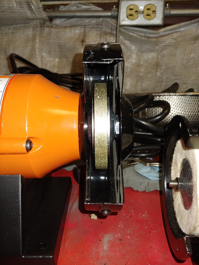

I had considered purchasing a larger diamond wheel for this new grinder. 'Even did a 2-minute Internet search for them. However it occurred to me that there wouldn't be any reason that the 3" diamond wheel wouldn't run on the 5" grinder. With that I immediately thought "so why bother? Just run the 3" one." And as fortune would so have it, that would be a good choice. Well, good for me anyway.
So I removed the diamond wheel from the mini-me 3" grinder, removed the plastic bushing, re-installed that onto the stone wheel and returned the 3" grinder to the configuration it came in. I then mounted the diamond wheel onto the 5" grinder - and it was oddly refreshing that no bushing was needed - and secured it with the retaining nut. I reinstalled the housing side wall/cover and this was the result:
Which admittedly looked rather strange upon first glance. However when I considered that there would be way-ample room to fit your tungsten in-between the wheel and the housing, thus eliminating the awkward angle with which you'd need to hold the drill...well suddenly that picture seemed much more attractive to me.
And so I decided to give it a test run...
- grinder 19.jpg (49.76 KiB) Viewed 9713 times
- grinder 20.jpg (210.18 KiB) Viewed 9713 times

Pictures of the gap between the diamond wheel and the housing, as well as the more favorable drill-holding angle:
- grinder 21.jpg (206.05 KiB) Viewed 9712 times
- grinder 22.jpg (61.05 KiB) Viewed 9712 times

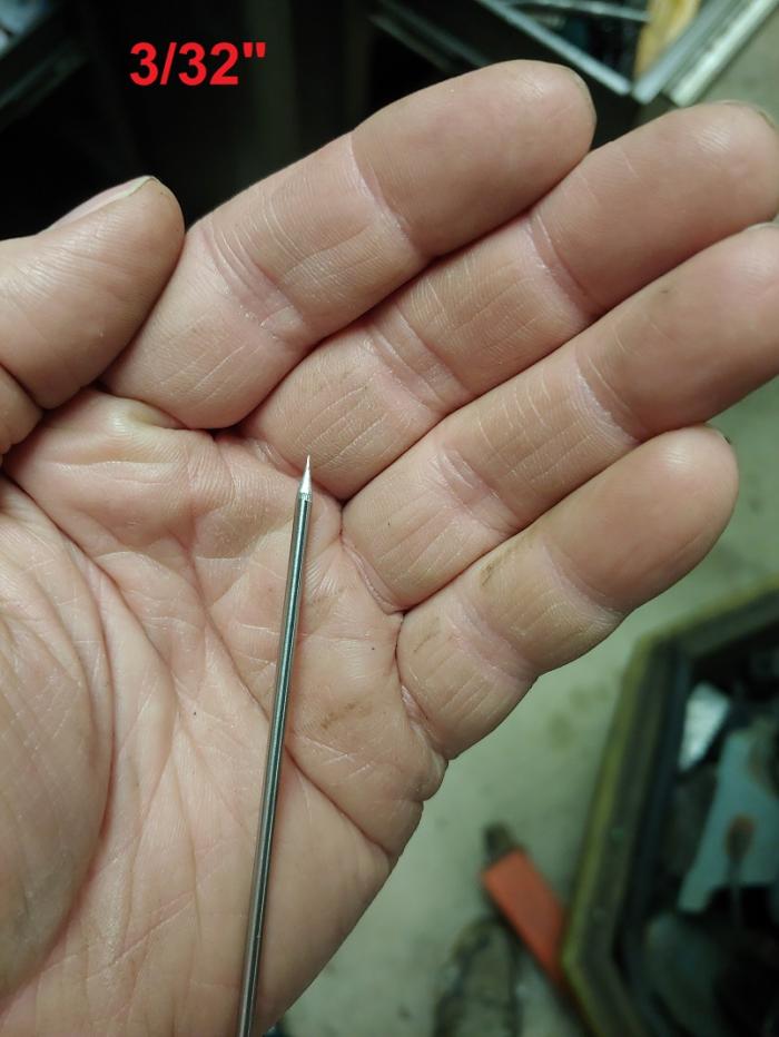

Location:TEXAS
The result was, to my inexperienced TIG eyes anyway, exactly what I would expected to have seen once a tungsten was properly sharpened. The 1/16" rod:
And the 3/32":
They were sharp enough to pierce my skin when attempting to take the above pictures, I didn't see any weird grain patterns and in fact those patterns matched what I had seen depicted as being the goal when doing this sharpening thing. For those reasons, I viewed this as a success. I attempted to take even closer pictures to offer for consideration, but the focus on the camera phone wouldn't cooperate, so...
- grinder 23.jpg (61.59 KiB) Viewed 9711 times
- grinder 24.jpg (61.6 KiB) Viewed 9711 times

The picture of your 3/32 tungsten shows a rather thin, elongated tip. Be aware, if you use that tungsten on higher amp welds you run the risk of that tip severing and becoming embedded in the weld. A major no-no for important welds.
This is a result of too flat a grind angle which is common with handheld grinding. A good and simple remedy is to fab up a small plate that allows you to align the tungsten to the wheel at your desired angled for consistency. It will also avoid grinding beyond the tapered shoulder. (Happens when you push in too far).
Grinding tungsten is an obsession to get them “just how you want” reliably. A bit of upfront effort and you can produce a setup to yield the results you seek.

Thank y'all for the feedback.
I agree with ya CJ, the angle that I produced on the 3/32" was too shallow. However that was neither intentional nor random. I was experimenting with different angles of holding the drill in order to see what would be required to produce either a shallow or steeper angle. The first of my grinds on both rods were indeed steeper in angle. I then wanted to see what I needed to do to produce a shallower one if I was planning on attempting a lower-amperage TIG weld. And I was able to figure that out. As it just-so-happened, that is where I decided to stop, thus the picture.
The main objective of this endeavor wasn't to become experienced with how to grind tungstens. That is the next step. Rather this "research" was aimed at merely developing a means by which I could do it at all. And do it inexpensively. That much was accomplished, so thumbs up.
As for your suggestion of creating a plate to get a desired angle consistently, that's a terrific idea! I'll have to look into that, thanks!
