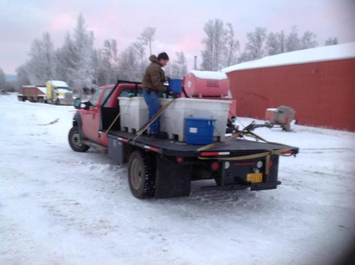

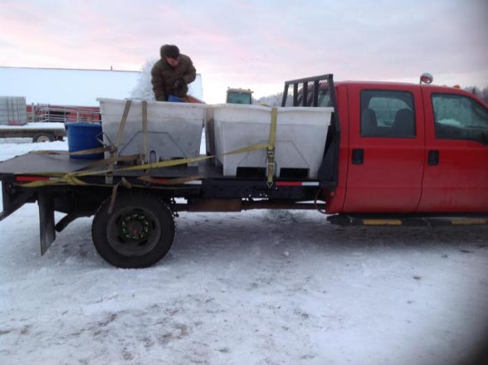

Still going strong, boys!! :D
    Sat Jul 06, 2013 11:16 am
John,
I see your three weeks of summer is already over, back to ice road trucking. :)
Rick_H
    Sat Feb 08, 2014 1:50 pm
    PA/MD
Braehill wrote:John,
LMFAO....I was thinking the same damn thing. We've been lucky not much of the white stuff up here YET.

I don't know how you guys do it, every year I swear it's my last here as I can't stand the snow. Then we get a mild one like we've had this year, only snowed and stuck twice so far. When you grow up you don't get snow days like when you were a kid, so I'm over it lol.

Thats one hell of a view.

I agree...I love to have that out my back door

In AUS, you can have A mountain view, not as spectacular, but nice, with out freezing yo ass off. But we are a fair bit lower than that pic. And closer to the equator.
