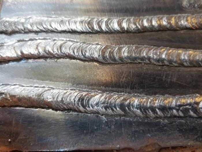

Not for nothing but your 6010 beads look similar to mine. Now I'm not the only one with that counterfeit 6010 rod.sbaker56 wrote:5p+ 6010 at around 95 amps, really should've marked a line so they came out less crooked.
top bead is -10 on the arc force, middle is 0 and bottom is +10

Did a bit more playing around today. My Lincoln Fleetweld 180 6011 runs way better than this cheap 6010 I got off ebay.
6010: (pretty fugly, all at 95 amps)
6010 root: (95 amps)
7018 fill over the root: (some undercut, run hot at 122 amps)
Another 7018, no 6010 root: (cold at 122 amps, looks not too bad)
