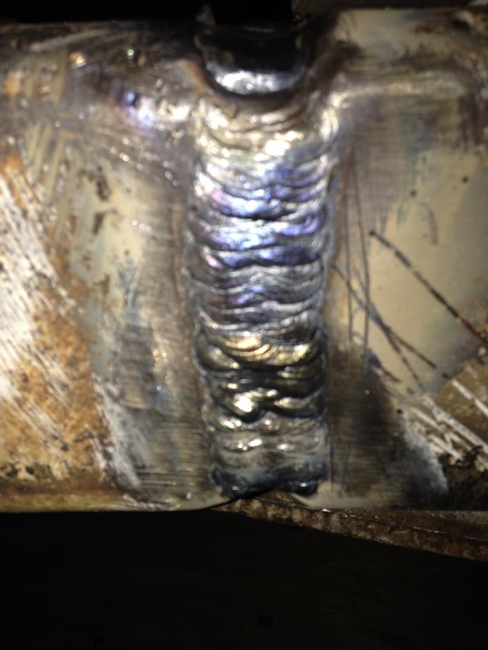

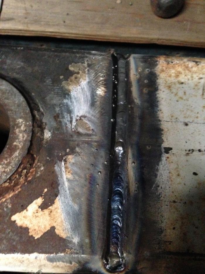

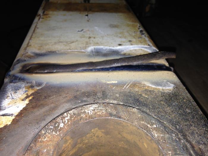

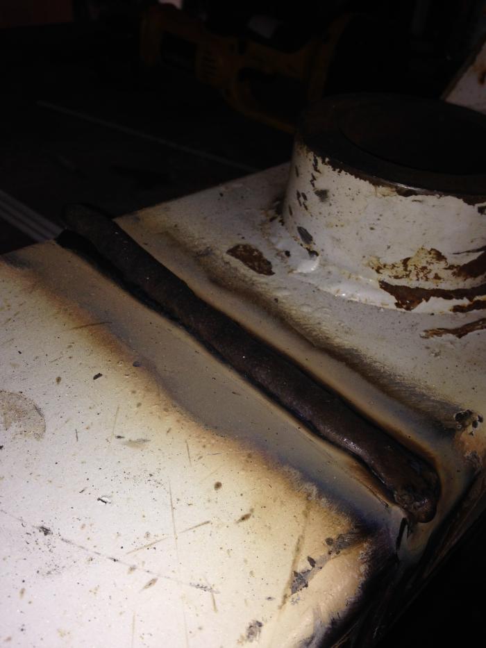

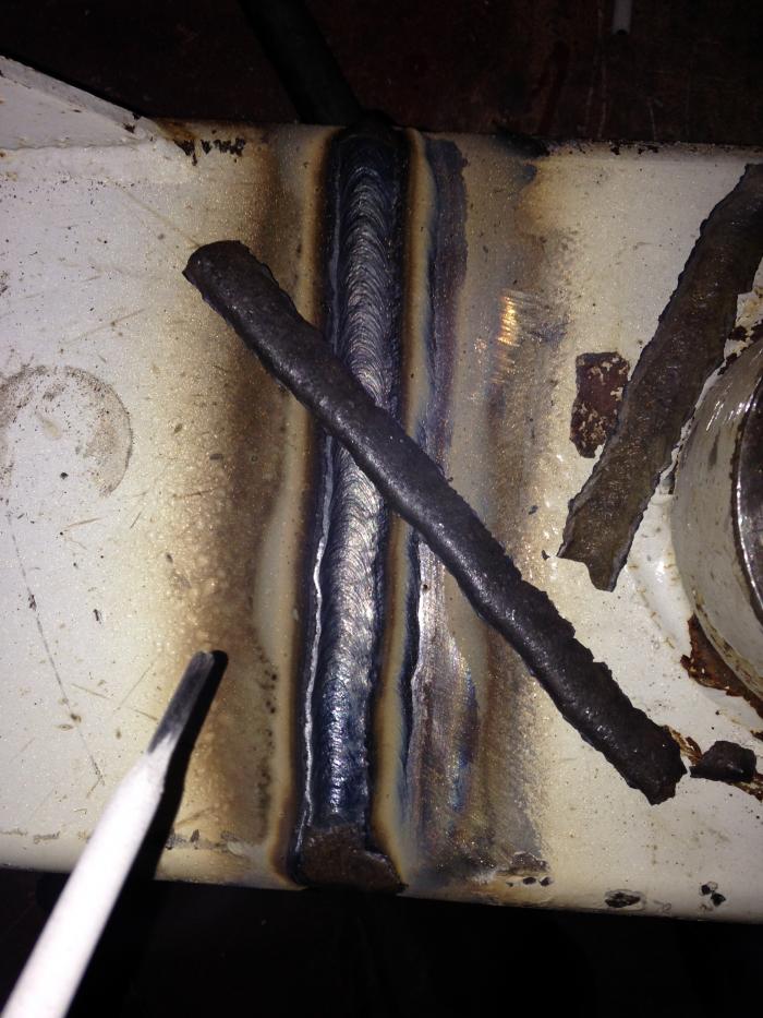

First passes.
1/8 7018 at 140 amps.
knife edge, and 1/8" to 1/4" root opening.

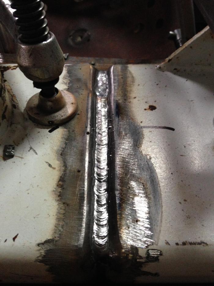

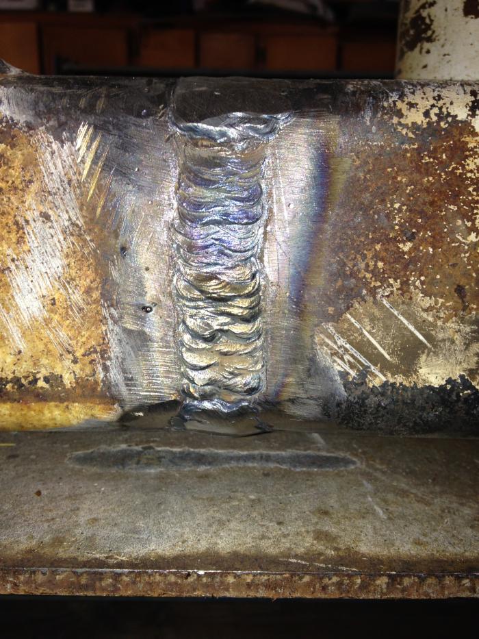

First pass is burned in, and read for the fill/cap.

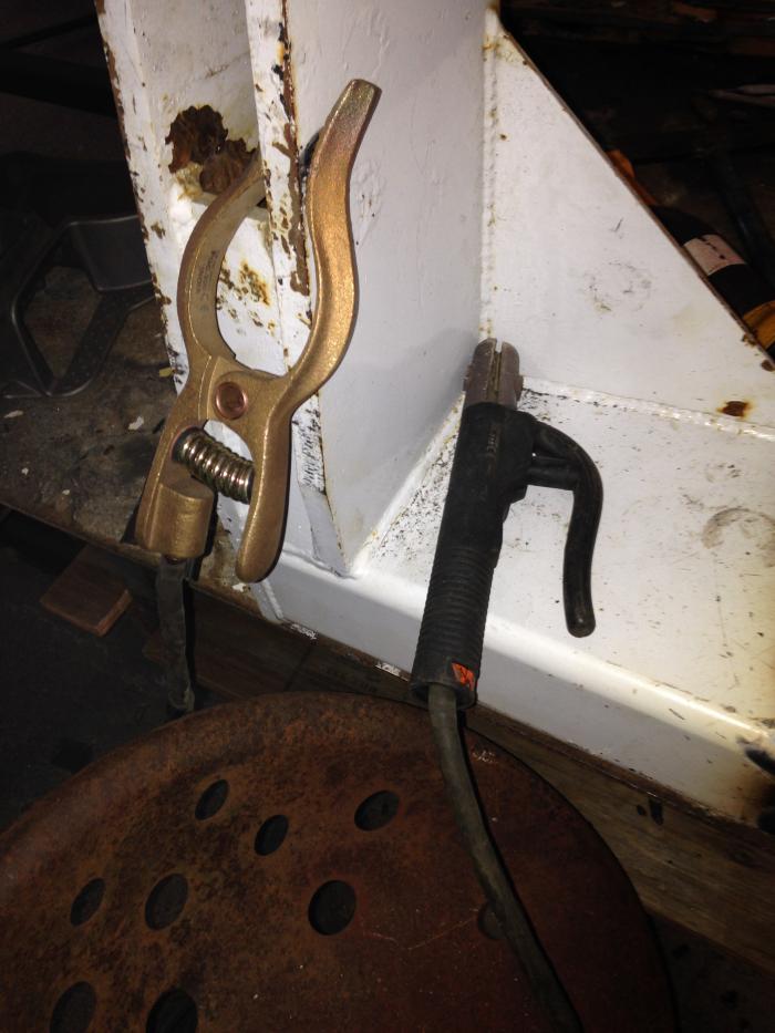

Using 5/32" Esab 8018.
Invertec 250 set at about this range.

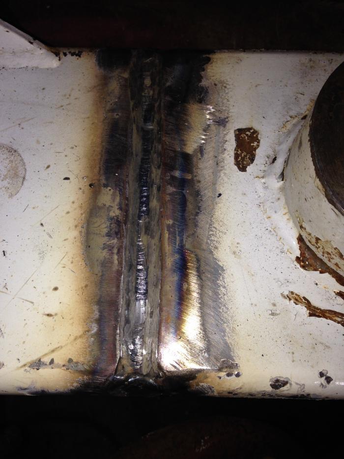

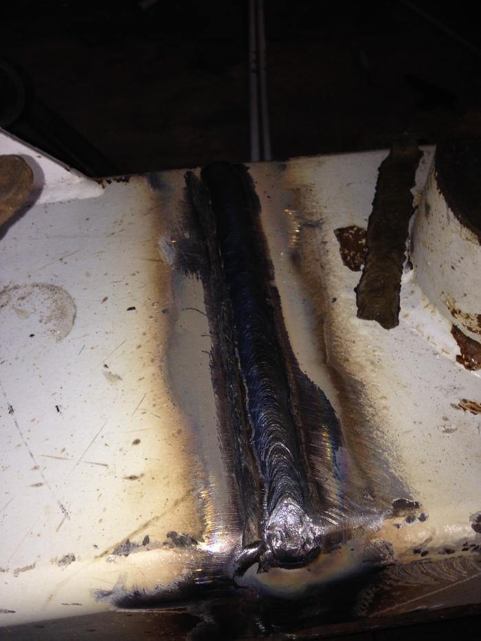

Decided to run a 3g on the bottom.
Need practice for sure. :)

I reaaly should have used 5/32 7024 for capping.... :cry:
Oh well,
Next one I guess.

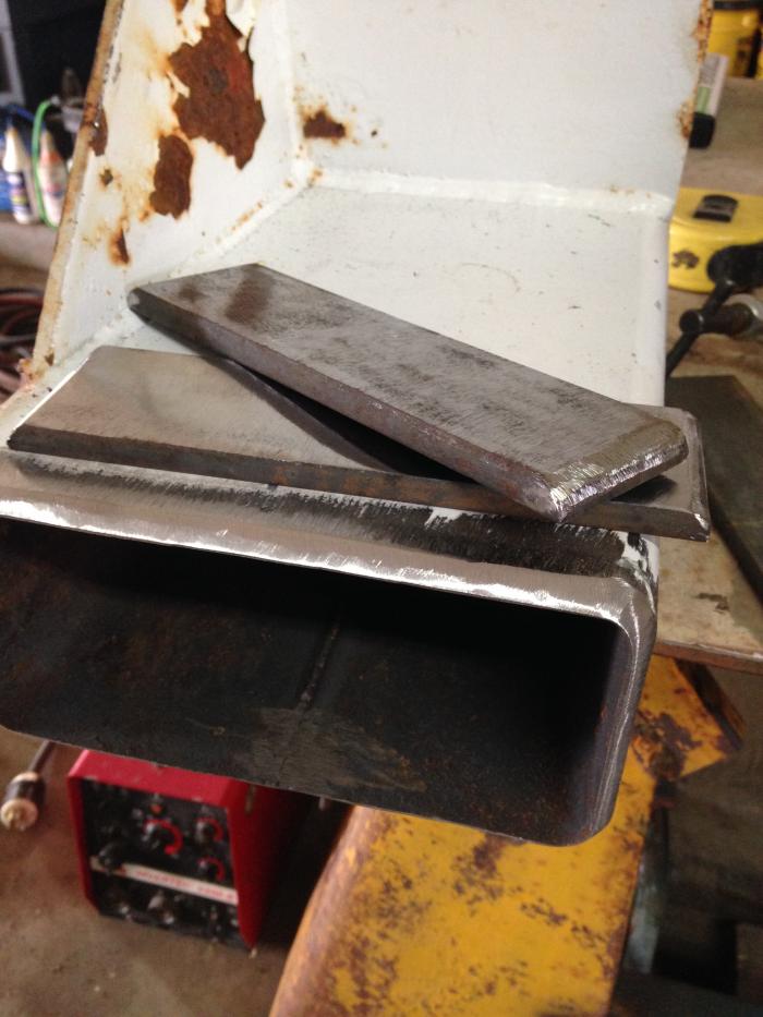

John,
Thanks for the pictures. That looks like a lot of hard work there. I will say good job. The only thing is the backer plate is not necessarily needed but it won't hurt anything. Keep us posted in your projects, I for one look forward to the pics.

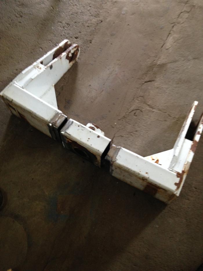

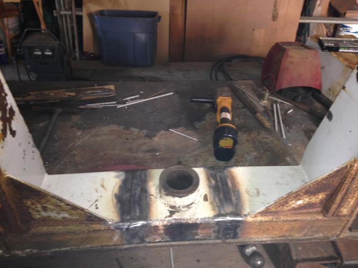

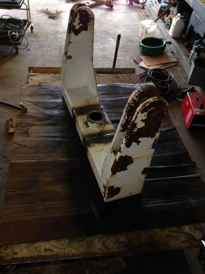

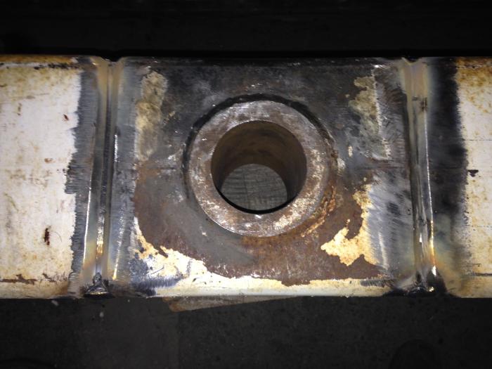

A recap of all 8 sides.
    Wed Oct 23, 2013 3:30 pm
    Palmer AK
    Palmer AK
    Palmer AK

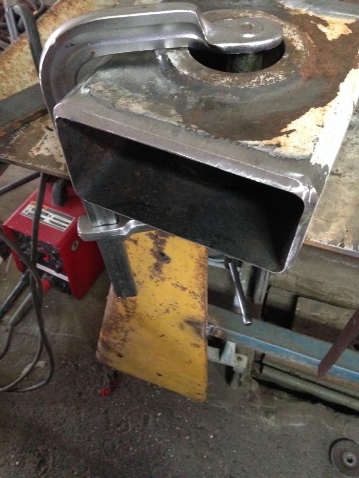

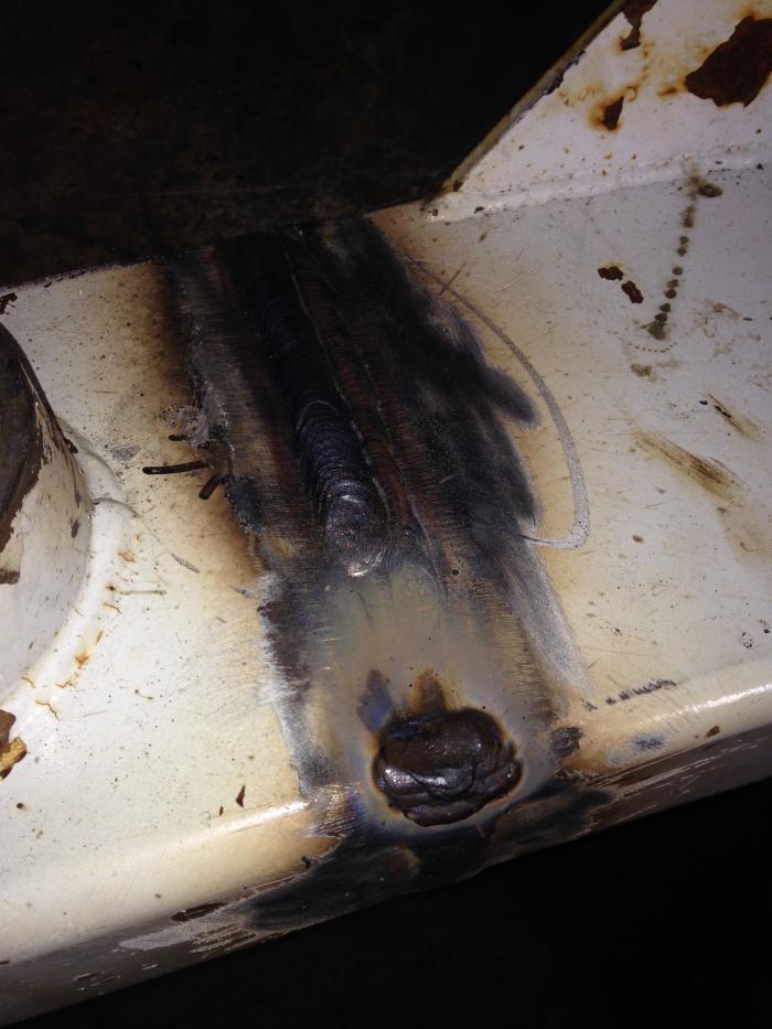

Need to wire wheel it down, and paint it....
Welds always look better with paint... :mrgreen: :mrgreen:

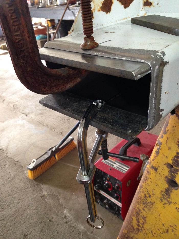

Need some feedback guys...... :idea:
    Tue Jul 01, 2014 4:34 am
    Skiatook, Oklahoma
Looking good so far.
But it's hard to say, without knowing what the final product needs to look like. [WINKING FACE]
