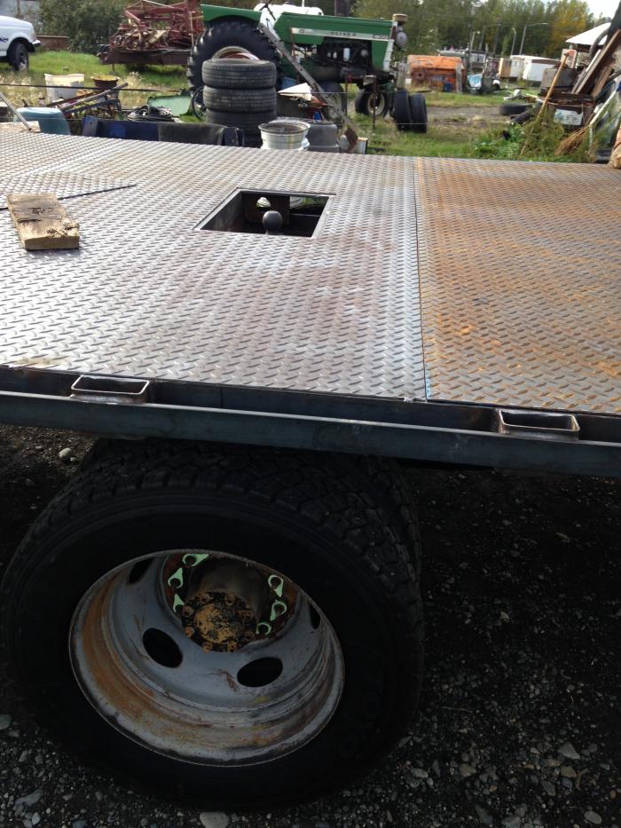

We'll finish building the bed, pull the bed off, flip it over, finish welding underneath, paint everything 6" back from the front, flip it back over, build the headache rack, paint the front 6" of bed and paint the headache rack.
Than put it back on the truck.
It will be easier to flip it over without the headache rack.
If that makes sense... :D

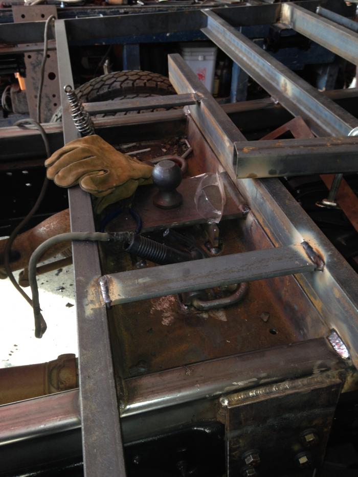

Your ball hitch doesn't have flat edges on the top base, so I don't think the idea of tightening it with a wrench top-side will work. I've only ever seen them installed with a large impact gun (like 650ft-lb), and you're not going to get that with a hand wrench. To that end, perhaps cut an access hole under the ball to fit a large socket onto the nut for tightening.

I tightened that big ball down very tight. And a locking tab welded on the bottom. In case you missed it.
My thinking that the only reason the ball would ever need to come off, is that it was worn out.
It takes 100dreds of thousands of miles to wear this grade of ball out.
I'm not sure if I want to punch a 2 1/2" hole in my channel...
Would weaken it quite severely I'm afraid..
Should be adequate to perform it's prescribed duties.

I saw the locking tab, but it sounded like that was before trying to tighten it down from the top. I just know what it takes for the shop to put a ball on my truck, and ain't no way I'm getting it that tight by hand even with a cheater bar. But more concerning, I didn't see a hole in the thread for a cotter pin on the ball - that's to save your bacon no matter how it got tightened, and I don't think I'd want to install any ball hitch without one.

We (Me and the customer) had looked at a handful of beds.
But most were wood decks, no goose neck ball (And if there was, it was usually in the wrong place)
Some were different frame rail widths, and some were 11' long, some 14' long.
We couldn't find a bed even close to what we needed for this truck.
We could build a bed exactly how we wanted it.
That's what it came down to.
Total cost of supplies was about $2500,(USD) when you figure in all the stuff (metal, lights, wiring, paint, etc etc)
There was no way on earth that we would find a bed to fit this truck, without some serious modification.
This was the best route to take.
