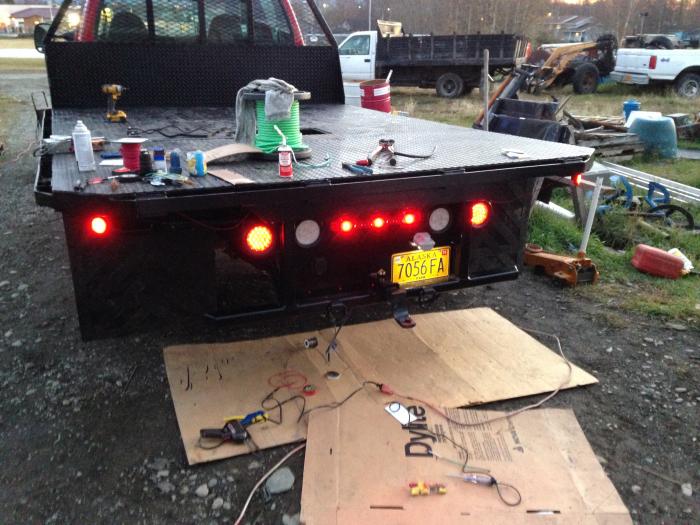

Splicing in the trailer plug.
This truck did not have thew towing package.
No dedicated trailer plug harness
    Wed Oct 23, 2013 3:30 pm
    Palmer AK
And it works, friends!
All wired up!

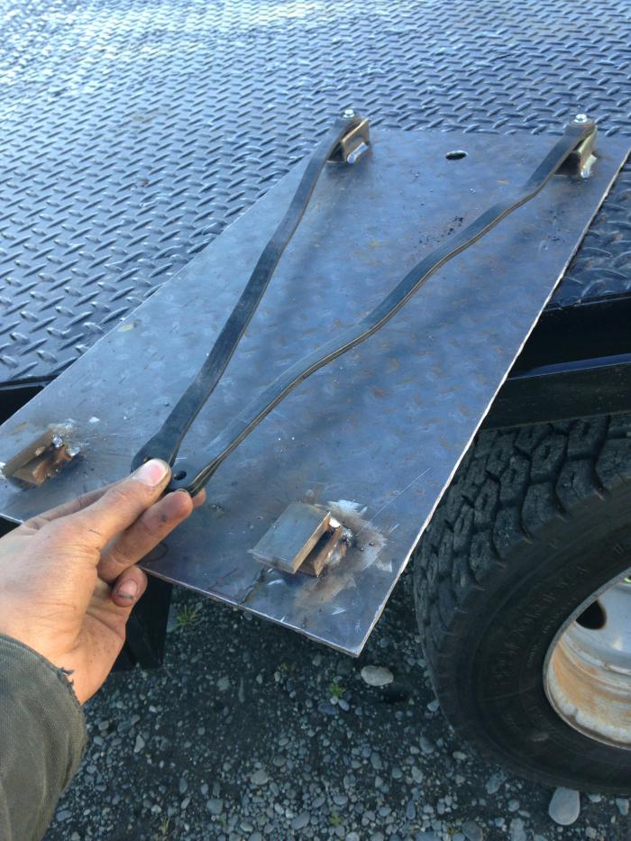

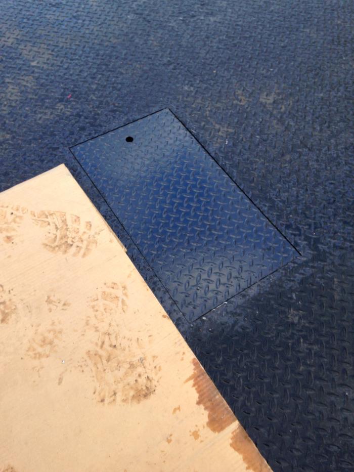

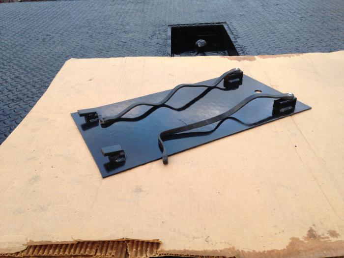

This is where you lost me. I would have put a hinge or some other form of latch on the cover. I see the rubber straps wearing out and in cold weather and repeated use breaking. That is my 2 cents. :)
Matt
    Palmer AK
mcoe wrote:This is where you lost me. I would have put a hinge or some other form of latch on the cover. I see the rubber straps wearing out and in cold weather and repeated use breaking. That is my 2 cents. :)
We've had them on our truck for 3 years now.
Still working...
We've ripped a lot of hinges off btw....
    Tue Jan 07, 2014 9:06 pm
    Elizabeth, WV
That is what I wanted to check because I have never heard of anyone doing this so I wanted to see what kind of response others had on that. :)
Matt

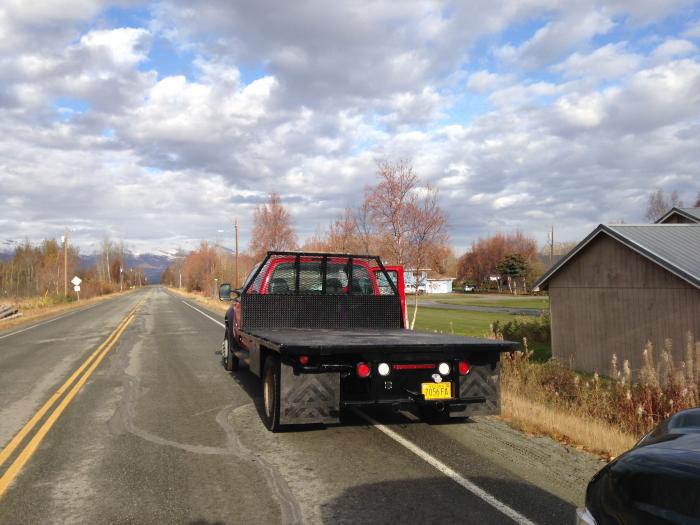

The truck is done, and performs great....so far... ;)
Looks pretty good from where I'm standing.... :D

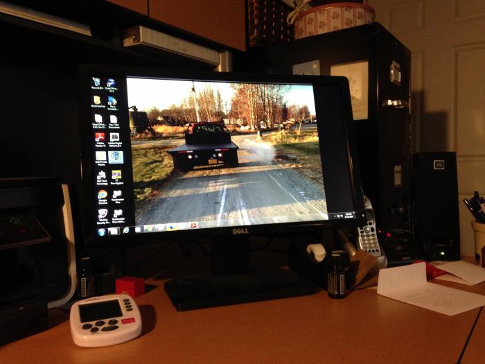

I even put the pic of the bed as the wall paper on my phone and computer.... 8-)

When I was a young man, I built trucks with platforms and buckets lifts for a living. Most had a flat deck with the other rigged parts integrated into it.
the chassis were long, and the design we used saved weight and metal. when you're building a truck, weight is a factor, as any you add takes away from the gross.
it was a rectangle with an" X " in the center sitting on top of the frame then, all the cross members were different sizes and welded to the " X " section notched into the rectangle 50/50 then welded.
this was a very ridged design and super strong. I remember, we built a mack all wheel drive truck with a 70ft bucket lift and piled 15 shop guys on the fully extended bucket & boom trying to flex the frame without the out riggers down.. just ever so slightly feeding hydraulic, just getting to tip and release pressure slowly.
truck would have flipped if the kept feeding it hydraulic pressure..
you don't want flex, flex will work the bed to death...and some of that diamond plate is funny material as it is and cracks easily when work hardened.
Also, use a thin strip of 1/4 Teflon liner or hardwood block between the truck frame and your body frame. the frame flexes like you cant imagine, with the flex and nothing in between, depending on the load and what's working at that time, the bolts can and will shear right off the frame, U - bolts are proven better choice
one can tell Lots of love went into your build... nice job!
