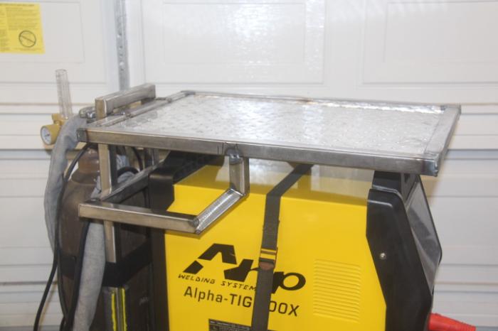

This is my hybrid welding cart.
I call it a hybrid because I started with an AV (audio visual) cart and added some features.

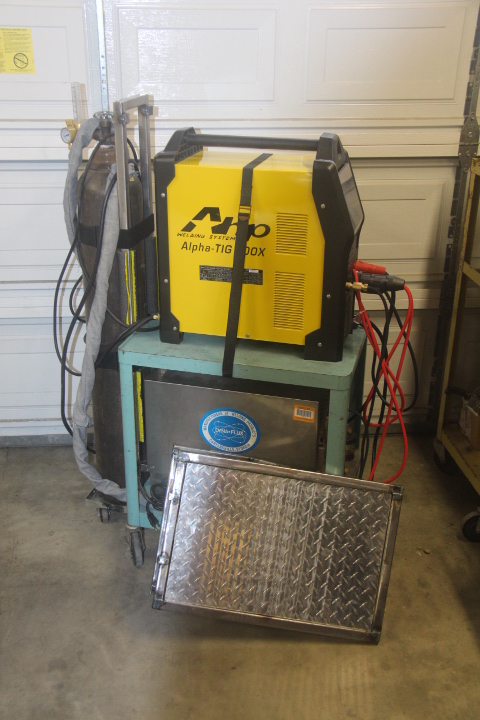

Initial placement of welder and water cooler.
This is how I used the cart while I was deciding what to build. The argon bottle is chained to the shelf unit.

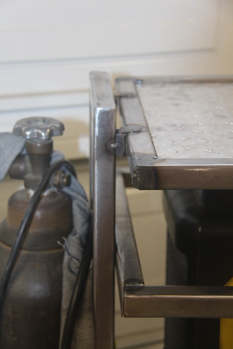

I added a bottle support to the cart. I used velcro luggage straps (from Home Depot) to secure the argon tank and water pipe insulators to pad the frame.
I added a removable shelf to the cart.
Cart with shelf removed.
This is the hanger for the shelf.

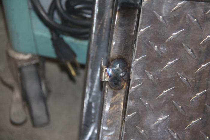

And here are the clips on the shelf.
A close up of the frame and shelf.
A close up of the shelf.

Nice-compact and neat. What I really like are the 4 caster wheels for easy maneuvering. If your shop is limited for space at times like mine it sure is nice to be able to grab it anywhere and it will follow.
Thanks. My shop (or garage) is pretty cramped and the cart only needs to move 2-3 feet.
