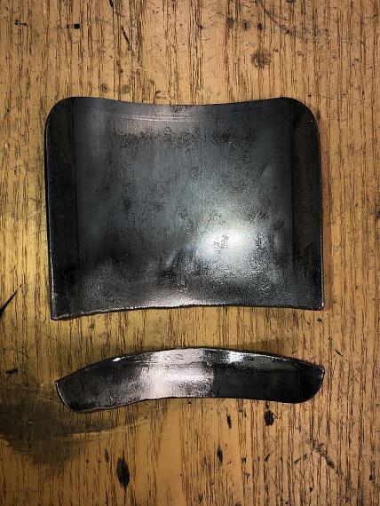

I am making between 30 and 300 of these plates. These are used to bolt on the inside of a very fat tire for an electric bicycle in order to repel nails and screws. Each bicycle tire gets about 26 of these. This is about 9 added pounds so it is only for ebikes with a very large motor.
I am using 14 gauge (.080") hot rolled mild steel because I could drive nails through 16 gauge. I tried 5052 aluminum, but it was very soft. I am making prototypes now; the production plates will probably be titanium but possibly Kevlar.
Here is one plate. It has the curvature of a 5" diameter circle (does not need to be too precise). The main base is 3" long (tolerance here is a loose 1/8"). The plate has a protective overhang which is about 7/8" (1/8" too short or long starts to cause a problem).
The only precision tolerance is that they should each weigh about the same (for wheel balance). The closer they all are to the same weight, the better. The weights are standardized in the last step by grinding off some material.

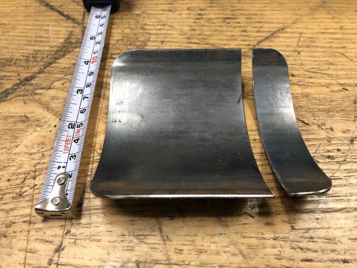

Then I shape the metal on a 4 1/2" pipe with a sledgehammer. I know it is low tech.

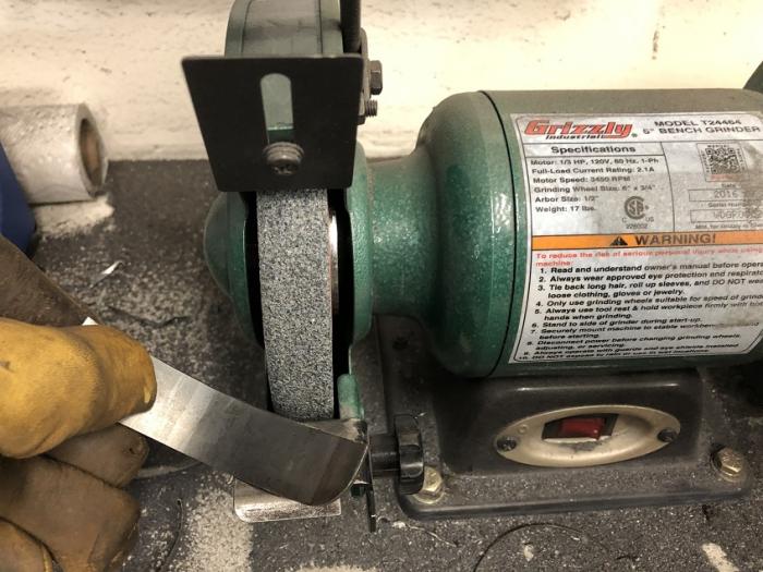

Now I have two curved pieces and I hand fit each one on a bench grinder. The overhang goes up at an angle.
- IMG_4584.JPG (68.62 KiB) Viewed 5131 times

Here is the overhang at the grinding wheel:
- IMG_4586.JPG (64.02 KiB) Viewed 5130 times

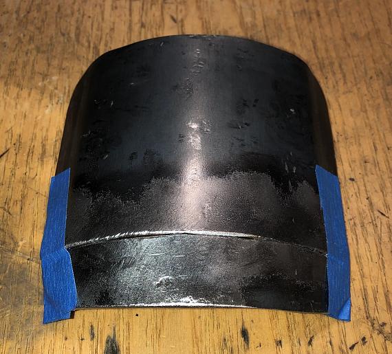

After I get an okay fit up, I remove the mill scale with a wire wheel and clean with acetone:
- image_15322.jpg (63.35 KiB) Viewed 5129 times

The best way that I have found to hold the two pieces together for the first tack is with painting tape:
- image_15323.jpg (58.75 KiB) Viewed 5128 times

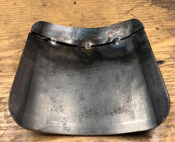

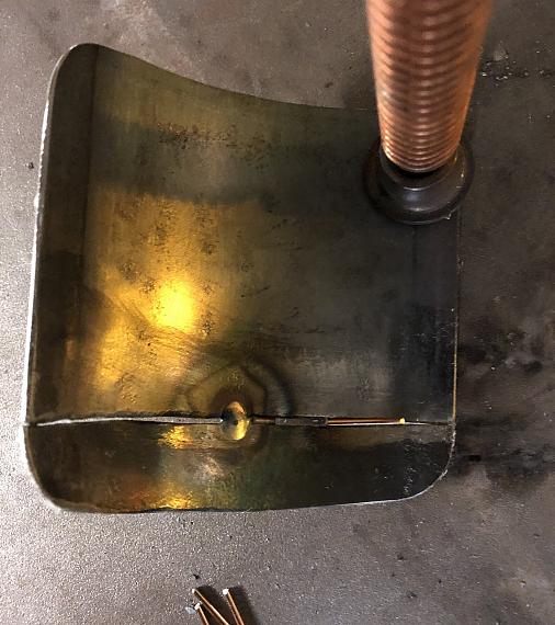

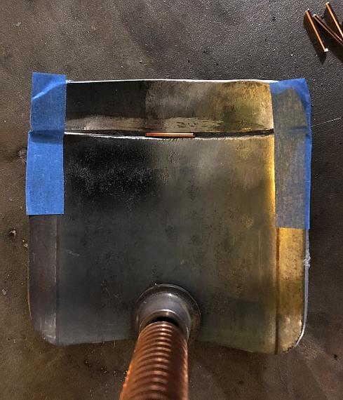

For the rest of the following pictures, I had to create a gap because it was 3 AM and I didn't want to use my bench grinder and disturb the neighbors. Most of the time the fit up is better:
I clamp it down on the welding table and do one center tack on the inside, so that it will warp upwards. The upwards curve is beneficial for the product application because it keeps the plate away from the adjacent plate while the tire is flexing while in motion.
- image_15324.jpg (33.9 KiB) Viewed 5128 times

This is disgraceful. The filler there is ER70S-2. I really should have been working during normal hours and been able to take it to the grinder to make the adjustment:
- image_15325.jpg (47.56 KiB) Viewed 5127 times

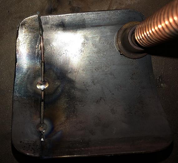

So now it is tacked a bit, but I had to take the time to remove the painter's tape and clean off the adhesive with acetone:
- image_15326.jpg (45.8 KiB) Viewed 5126 times

More disgraceful filler rod used to fill the gap for the second tack. Like I said, usually I have a better fit up:
- image_15327.jpg (49.71 KiB) Viewed 4782 times

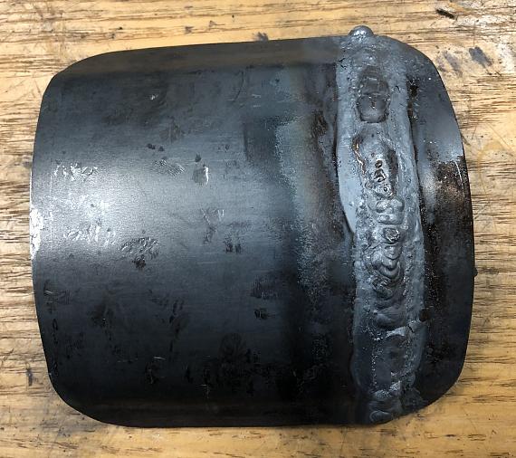

Normally, I run a TIG bead on the top. With this example, I had to do a root pass. I really should have posted a plate with a good fit up.
- image_15330.jpg (45.72 KiB) Viewed 4778 times
Erik Mannie
- Erik Mannie
Joined:Thu Apr 12, 2018 10:36 pm
Remembering that I am new to TIG welding, I ran my best bead over the root pass:
- image_15331.jpg (68.34 KiB) Viewed 4777 times

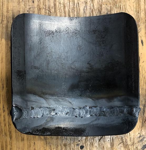

If the bottom of the plate ("the other side of the seam") needs it, I will run a bead there, but the back side seemed to be good:
- image_15332.jpg (58.73 KiB) Viewed 4777 times

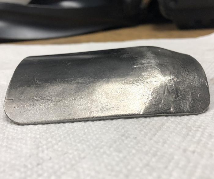

So clearly a skills deficit here, but I am signed up to go to Hobart in January. It really does look okay after grinding.
These go inside an ebike tire, so they don't have to look good, but the weight distribution should be as precise as possible.
It is kind of a strange situation because I am making the prototypes out of steel. Each design attempt needs about 30 plates made in order to be tested. If the final version were to be made of steel, I could make a fabrication process. Is it normal to just hack together prototypes like this? This design will probably evolve after the testing phases.
I'm not sure if it would have been worth it to have the flat pieces cut on a plasma table so that I could have enjoyed uniform weight and better fit up.
My main question is: would you guys and gals weld both sides of the seam? Isn't the theory that a good weld bead on top would suffice? To what extent does the additional heat of an extra bead (if deemed necessary) weaken the plate? The 14 gauge, as it comes from the supply yard, passes the destruction test. I wonder if my HAZ would survive a nail or screw being hammered through it. When I have a chance (I always work during the day), I will try to hammer a big, hard and sharp nail through the bead and HAZ.

I’ll wade in with some impressions...
First, your gas setting is too high. You really only need about 12-15cfh for a #8 cup with a gas lens. 3/32 tungsten is fine, grind to a crisp point, don’t blunt it.
For the application, you do not need 2 passes of weld. Heck, probably 5 tacks is plenty strong if you are welding with an open root. Me, I’d consider welding the pieces together before bending or stamping them. Welding flat pieces together is much easier. You might need to perform a single, full pass though.
Your beads show insufficient heat, but likely due to using 3/32 filler. Drop to 1/16” using the same heat. Tack both ends without filler, then lay a single pass with the slightest weave across the gap. This should help you flatten the bead and burn it in better. I’d weld the “inside” of the part away from the rim so any irregularities in the weld do not disrupt the fitment against the rim. Leave that as bare metal.
Here’s another idea: use silicon bronze wire instead of ER70. It does cost more, but it welds faster because you use less heat, thus you create less distortion in your part. For the application, it will be more than strong enough too.
Last bit of advice- if you lay your first bead and it is humped up, uneven, and ugly, run a second pass without filler, just using the torch and “wash” the bead in. Use your pedal to avoid over-melting the weld, but enough to manipulate the weld. You’ll get better looking results and insure you’ve made proper fusion/penetration (as long as you don’t go nuts).
